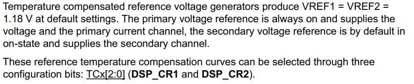

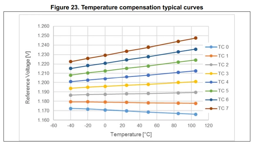

0693W00000Bb1WzQAJ.pngHow to know what curve do I need? In what cases do I need temperature compensation?
Datasheet says "Reference voltage generators with programmable independent temperature compensation". What does word "independent" mean?
Datasheet says only that:0693W00000Bb1XxQAJ.png
