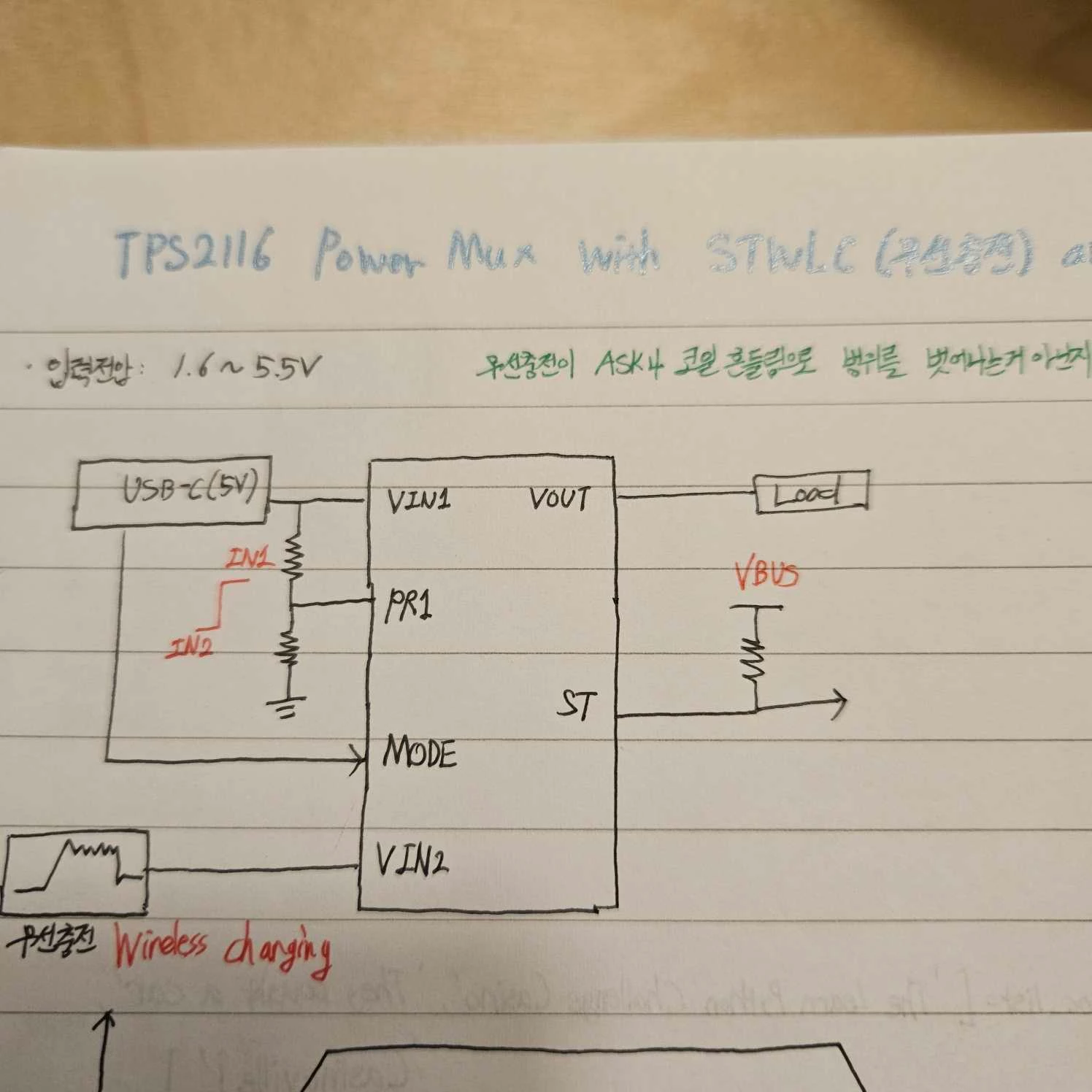

Hi JReid.1, I am nobody but interested in wireless charging (not ST employee).
Have you tried FOD tuning using STWBC86?
If you get connected with ST vendor, they will give you the detailed document tuning FOD parameter.
I've tried it, and as far as I experienced, it worked well so far (method is to measure all the received current level regards to every load volume, step by step)
By the way, if you are interested using wireless charging and wired charging both, using power mux and outputs single one, please reply me. I will be very appreciate it.
It seems the wireless charging's output fluctuates so hard so that the power multiplexer cannot handle the drop, and resets in very short term frequently. Of course no output come out.
Below I attatch the simple diagram, any thoughts or ideas please keep me in the loop.
Thank You.
JAKE2
January 22, 2024
It was not the fluctuation nor the STWBC's problem
It was setting high voltage regarding the Mux's input.
When setting Vout 5V → 4.5V , problem disappeared.
