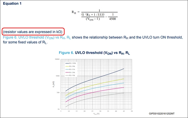

Hello. I am evaluating STEF01 for a PSU application.
I am trying to calculate the values for RH using the formula provided in the datasheet. But my calculation result for RH is not in line with chart given in figure 6 (page 8 of the datasheet). Referencing the chart, for a value of RL of 10K, and a required UVLO of 12V (=Von), I would expect RH around 60kOhm.
But my calculation is far apart from expected value:
From
RH = 1 / { [ (1/RL) + (1/333) / (Von-1) ] - [ 1/4500 ] }
I get 16,703 Ohms with Von=12 and RL=10k:
1 / { [(1/10000) + (1/333) / (12-1)] - [1/4500] } = 16,703
Very obviously my calculation is wrong, but why? Please advise, thank you.

In mentioned equation you have to enter resistor values in kOhm (not in Ohm), see note below “Equation 1�? in datasheet:
In your calculation if you remove last “000�? for RL value you will get RH around 109k for RL = 10k. Please verify.
Sorry for confusing formula in datasheet.
