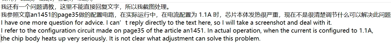

Wyoun.1
Wyoun.1Author
Aug 31, 2021 1:10 AM UTC

Dear @Wyoun.1​,
Please open a new post for this question. This way will be easier for other users with the same problem to find the solution.
Thanks
