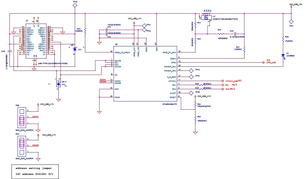

Hello,sir/mam
We have developed the schematic as per the reference of the STREF-SCS001V1 Board.
I know the STUSB4500 requires PD enable charger as its source so we have taken PD enabled adapter.
I have been using STM32F072 EVM board to detect the STUSB4500 IC .
I have imported the "NUCLEO_F072RB_STUSB_UART_NVM_config_1.04.bin" File in the STM32F072.
I took out the connection(SCL,SDA) from my PCB ,Also connected the PD enabled Adapter and combined my Circuit and STM32F072 Ground.
After uploading the .bin file when i am opening the GUI its Showing Error STUSB4500 not detected.My LD2 green LED works fine on STM32F072 EVM board.
I am attaching you my schematic please verify and suggest solution regarding this.
Your help would be appreciated.So waiting for your Quick response.

  • 1) The I2C interface requires pull-up resistors on both SCL and SDA.
Please make sure you have pull-ups, because I didn't see them on your schematic.
  • 2) Note that older versions of the STUSB4500 GUI had some issues to detect the Nucleo board on some computers.
Please use the latest version of the GUI (v1.0.8 or later) :
https://www.st.com/content/st_com/en/products/embedded-software/evaluation-tool-software/stsw-stusb002.html
  • 3) To check the proper detection of the Nucleo board, you can use the Nucleo HwCheckUtility (in attachment).
