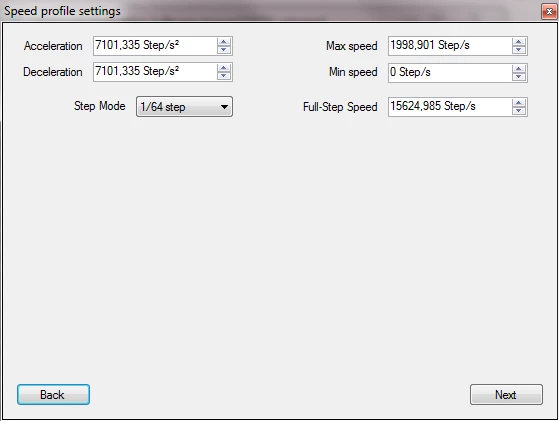

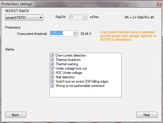

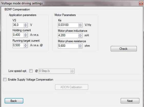

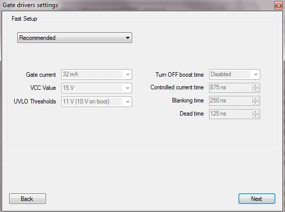

I use SPINFamily tool for ihm03a1 to calc my settings. I try to select Vth, but I can see unreal Ith like 38,46 A. Why?0693W000003POeHQAW.png 0693W000003POeCQAW.png0693W000003POe7QAG.png0693W000003POe2QAG.png0693W000003POdxQAG.png
ARöss.1
ARöss.1Author
Aug 21, 2020 3:33 PM UTC
@dungeonlords789​ The 38.46A seem reasonable with an over current threshold of 1000mV. How did you arrive at this value?
dungeonlords789
Aug 21, 2020 9:08 PM UTC
If 1000mV threshold means 38.46A why ST gives me possibility to use this level for 10A powerstep01? 38.46A is unreal for 10A driver, isn't it?
ARöss.1
ARöss.1Author
Aug 23, 2020 7:48 AM UTC
It's a theoretical limit based on the Rdson I guess. @Cristiana SCARAMEL​
