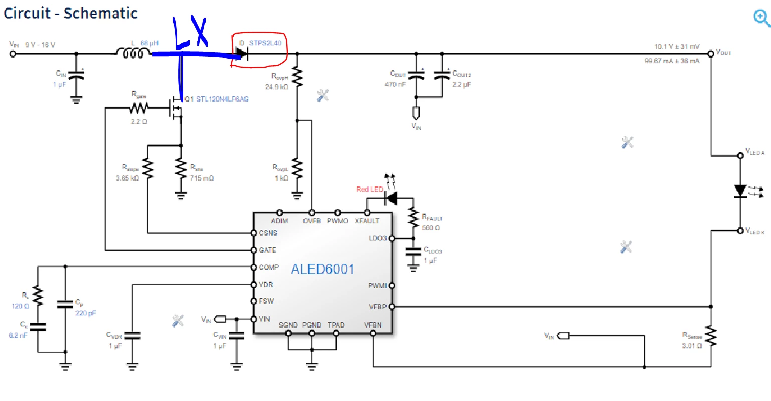

Hi I use STPS2L40U in the buck-boost circuit. ​

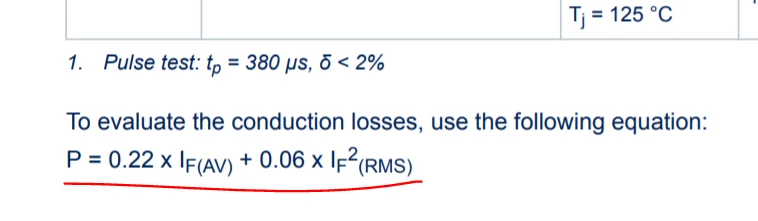

I read STP2L40U datasheet. It shows Schottky rectifier diode P=0.22xIF(AV)+ 0.06xIF(RMS) 2.
0693W00000FAb6kQAD.pngI have three question.
  1. What are 0.22 and 0.06 meaning?
  2. Does IF(RMS) mean LX path current or others?
  3. P means power and unit is watt. ​In this equation right side, the unit is amp and amp square not watt. Is the equation correct?

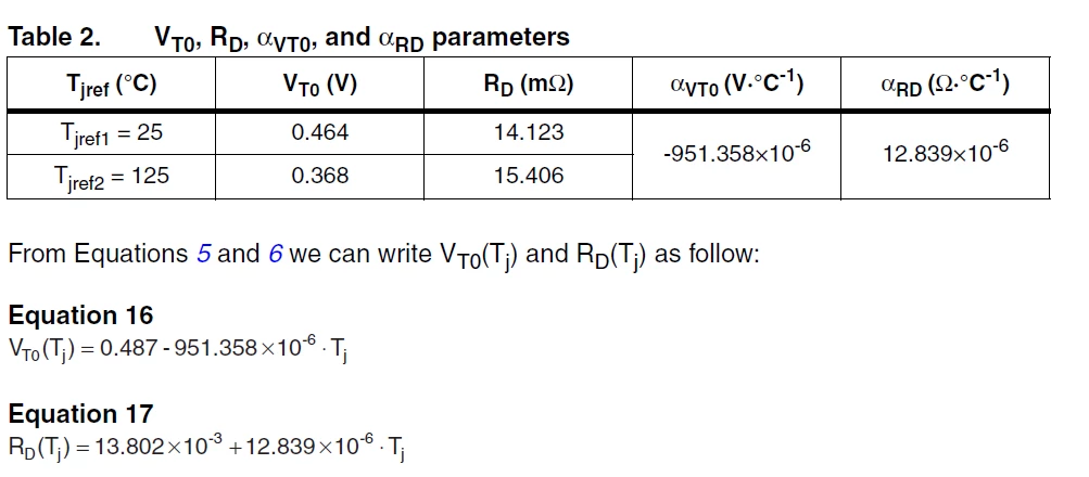

0693W00000FAei0QAD.pngI know how to calculate Table 2, but I don't know why Vt0(Tj)=0.487 - 951.358 ×10 ⋅Tj and RD(Tj ) = 13.802 ×10-3+12.839 ×10 ⋅Tj.
Where the 0.487 and 13.802 come from?
