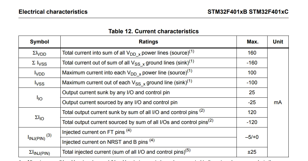

    Given these are FET inputs the input current is negligible for standard GPIO pins, i.e. a 100Kohm pullup or pulldown can easily drive an STM32 GPIO input. -but- if you are hitting the pin with a high frequency digital signal, then you'll need to charge the pin's input capacitance pass the Hi/Lo voltage threshold before the new state is detected (i.e. lower resistance at higher speed data). Also if driving an analog input then you need to charge the sampling capacitor fully to the input voltage, which means a low impedance input source for higher frequency signals/sampling.
    The input voltage for Hi/Lo will depend on the Vcc supplied to the IC, expect for 5V compatible pins. Check the MCU's datasheet for the specific GPIO pin's input threshold.

    0693W00000KdVn2QAF.pngNot sure about Minimum Current, but as per STM datasheet the maximum current rang is up to 25mA. you can see it in the datasheet page 58, Arm® Cortex®-M4 32b MCU+FPU, 105 DMIPS, 256KB Flash/64KB RAM, 11 TIMs, 1 ADC, 11 comm. interfaces (st.com). I search it, and assume it ranges from some uA to 25mA.

    I want to know regarding STM32F401 GPIO pin. How much minimum current will be required to drive the pin as input?
