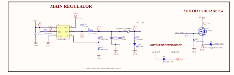

How i can increase my pcb/product life up to 5years for long term
  • April 18, 2023
  • 3 replies
  • 2945 views
_legacyfs_online_stmicro_images_0693W00000biHyiQAE.pngI simply mean that how I can test and verify all the sections of my PCB like here I'm sharing PCB Schametic power section because main section is power section so let us know what things I should keep in mind and so on,
so main agenda is that here is the power section
and main loads are listed below
1 STM32F103C8T6 (max 20mA Current Consumption)
2 Digital 3 axis acc. STK8321. (1mA Current Consumption)
3 BLE PB3. (10mA Current Consumption)
4 4G A7672s Simcom module. ( Max 2A Current Consumption)
so just let us know all factors and things to make my pcb/product live long durability
like what kind of capacitor , ics , resgistor , pcb layout , and so on whatever you about it all you suggestion and guidance are welcome and appreciated
Thanks in advance

    For capacitors Aluminum Polymer may not dry out. For IC try to have multiple footprints it a packets is obsolete.

    I will get done multiple footprints of these changes but I couldn't get the first point about the capacitor
    Thank you so much whenever you have time, plz give us more feedback to the improvement of the ckt.

    I was talking about C28 and C29 in your schamatic, i dont know what kind of Cap you are using but a polymer type can last 10000 hours. (They say, dont trust marketing en test yourself)
    what kind of environment are you talking about?
