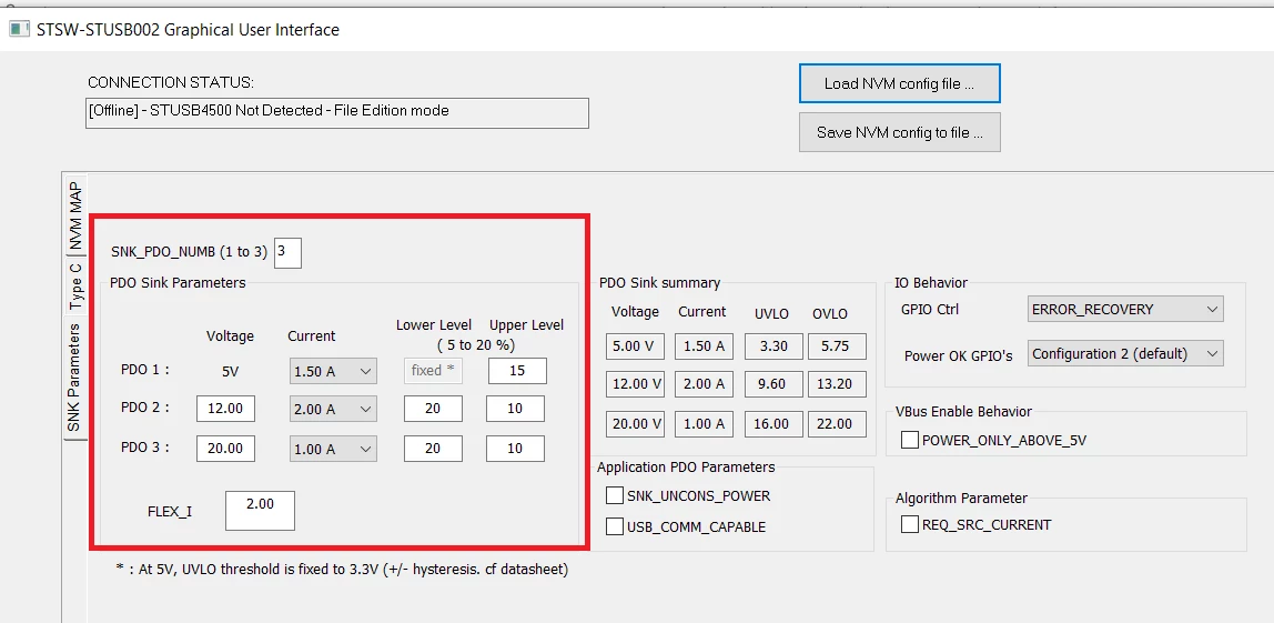

    CChin.2
    CChin.2Author
    Sep 21, 2022 1:41 AM UTC
    Hi Peter,
    thanks.

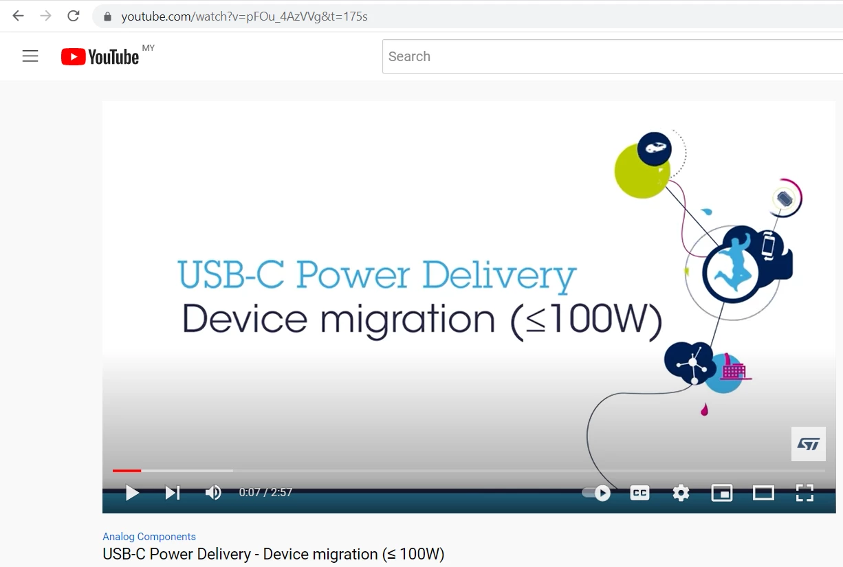

    from the video
    https://www.youtube.com/watch?v=pFOu_4AzVVg&t=175s
    what i see is that, the Eval-SCS001v1 has been pre configured with 3PDO (from lowest to highest)
    PDO1:5V/1.5A
    PDO2:15V/1.5A
    PDO3:20V/1.0A
    it shown when it connect to a 5V devices, it can automatically select the PDO1, then when it connect to a 15V devices, it will auto select PDO2. is my assumption correct?

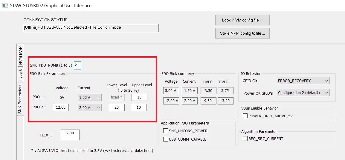

    if let say i want to power my uno with 12V.
    which 1 should i configured? or both also can,
    1st option ( 3PDO )
    2nd option (2 PDO)
    0693W00000SvqugQAB.pngthanks,
    Chin
    Peter BENSCH
    Peter BENSCHBest answer
    Sep 21, 2022 9:18 AM UTC
    This is somewhat misleading because the STUSB4500 on the EVAL-SCS001V1 cannot know what voltage supply the connected load wants and, above all, can tolerate. The 15V device, for example, would like to have 15V, the 5V device 5V. However, due to the lack of communication between themselves and the STUSB4500, neither can communicate this, so that the user has to program a corresponding profile into the NVM of the STUSB4500 if the maximum voltage is specified.
    It is primarily a matter of telling the power supply unit (source) on the USB-C side which power level is to be requested from it. The output voltage is determined according to the performance of the source: the PDOs are queried in sequence (see the data sheet of the STUSB4500) and the power supply unit is instructed to supply e.g. 20V, 1A, if it can do so. Of course, the load must then be able to handle the 20V.
    Is that a little more understandable now?
    Regards
    /Peter
