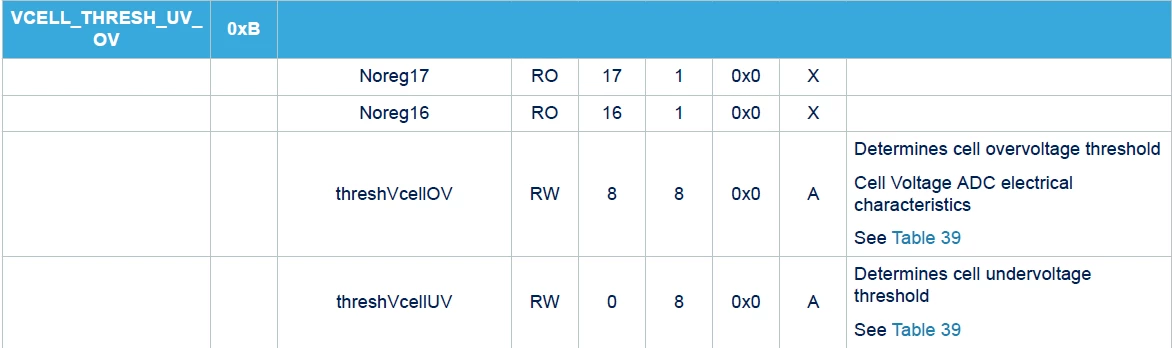

How can I set OV UV threshold of L9963E?
I'm trying to set UV OV value of my L9963E. I'm aware that writing "threshVcellOV" and "threshVcellUV" fields in "VCELL_THRESH_UV_OV" register to do that. However, there is no information about which bit values corresponding voltage values. At least I couldn't see.

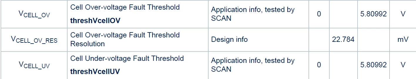

The table 39 just shows the max min voltage values of it.
