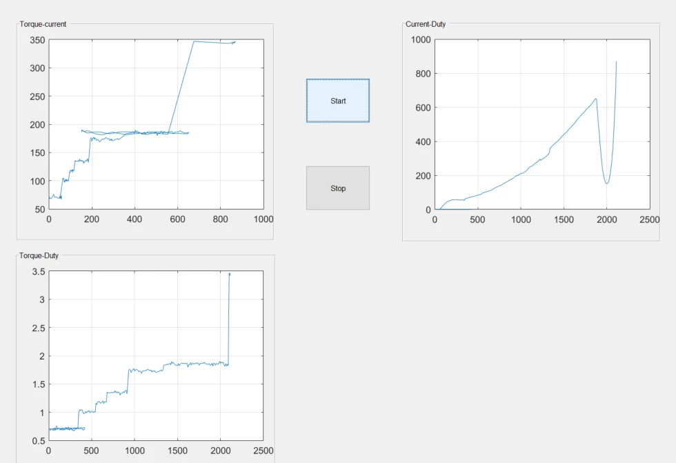

SMarm.1
SMarm.1Author
Feb 16, 2021 2:31 PM UTC
Thanks for the answer.
Yes, I'm using G431RB setting all peripheral like F401 and it works vary well. However, the problem with Vref doesn't change. I set, for example, 9V for voltage supply and Vref with PWM 100 kHz and D.C. at least 70% , the motor works but when PWM motor reachs 70% the DC motor saturates. The attached maybe is more clear to understand the situation. In the picture 2500 means 100% D.C.0693W000008GJHyQAO.png
Cristiana SCARAMEL
Feb 18, 2021 12:16 PM UTC
Hi @SMarm.1​,
what do you mean with "when PWM motor reaches 70% the DC motor saturates"?
If you mean that the current does not increase as the voltage increases, could be due to the system physical limits.
Even if you increase the Vref value the maximum motor current is limited by the effects of the BEMF and the motor windings resistance.
A numeric example, in your case (DC 70%) the max target current can be calculated as:
Vref = 0.7 * 3.3 V * (47 kohm / 247 kohm) = 0.44 V
Itarget = 0.44 V / 0.34 ohm = 1.29 A
The resulting current is limited by the abovementioned effects.
Let me know if these info are useful to you, if so please "Select as Best" button to close the topic.
