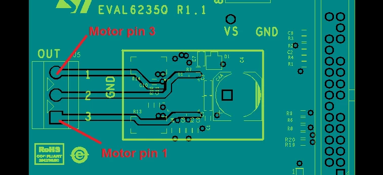

Hi, I am using L6235Q Evaluation board for my brushless motor. I connected the board to the motor and the motor not moving. the connection is so simple but the motor is not moving.
  • July 20, 2021
  • 16 replies
  • 4624 views
I am using 12V motor, all the phase I measured 12V, its look like it stuck at brake.
what can be the problem?
I am using motor 1028m012b - FAULHABER

Hi @IGAL TALOR​,
please double check the J5 connection.
The silkscreen near the connector indicates the IC OUT number, not the J5 poles number.
0693W00000D07B8QAJ.pngIf this does not solve the issue, it is necessary to check the device signals with oscilloscope.

IGAL TALOR
July 20, 2021
I connected:
OUT1 J5-3 to motor pin 3
OUT2 J5-2 to motor pin 2
OUT3 J5-1 to motor pin 1
you can see at the motor data sheet that I attached before.
