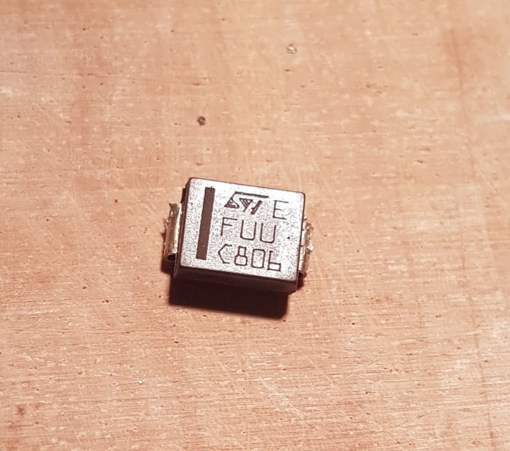

Help to identify this smd?
Hello =)
Do you recognise this component?
It's being used in this case between the +ve output of a bridge rectifier and ground​
I've searched ST & elsewhere and would appreciate your help to identify this & suggest alternatives to replace it.
​Many thanks, Craig

ST FUU DIODE
SMCJ40A-TR FUU
https://www.st.com/resource/en/datasheet/smcj12a.pdf

Awesome, thank you! 🙏🏻
