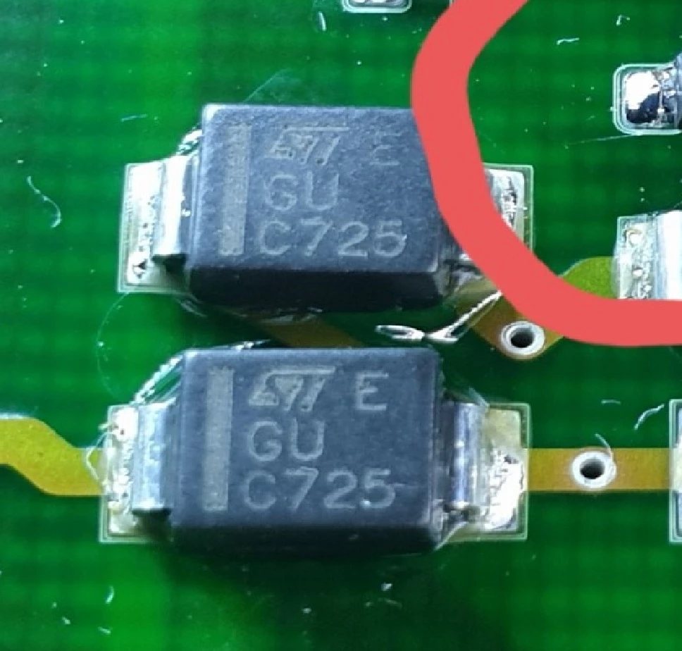

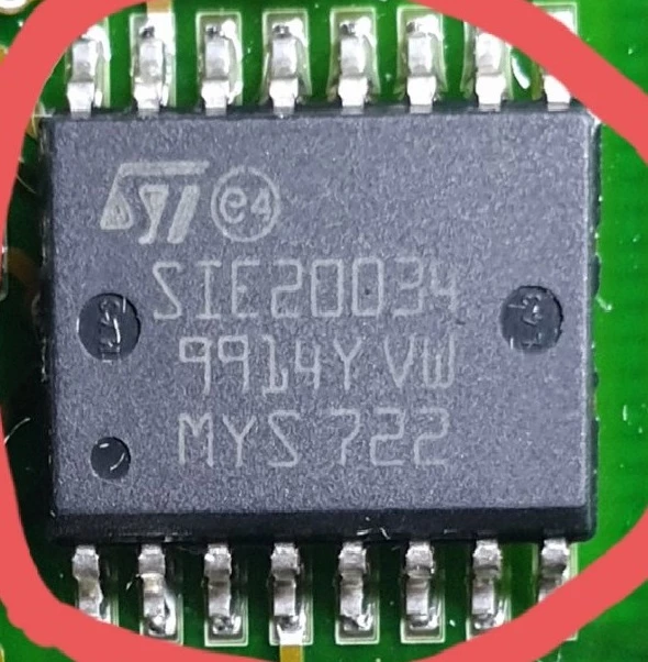

Please, Help me identify it and are there any analogues?

I think the SIE part is custom
ST GU DIODE
SM6T200A
6 replies
Tesla DeLorean
Tesla DeLoreanBest answer
Guru
Jul 24, 2021 10:02 PM UTC
ST GU DIODE
SM6T200A

Thanks :thumbs_up:​

Anyone have any information on SIE?

I am not asking a datasheet, please tell me what does "9914Y VW" mean in the marking?

Probably a production batch/code, and customer.
What kind of circuit is this in? Can you identify any of the signal and ground pins from the PCB?​
