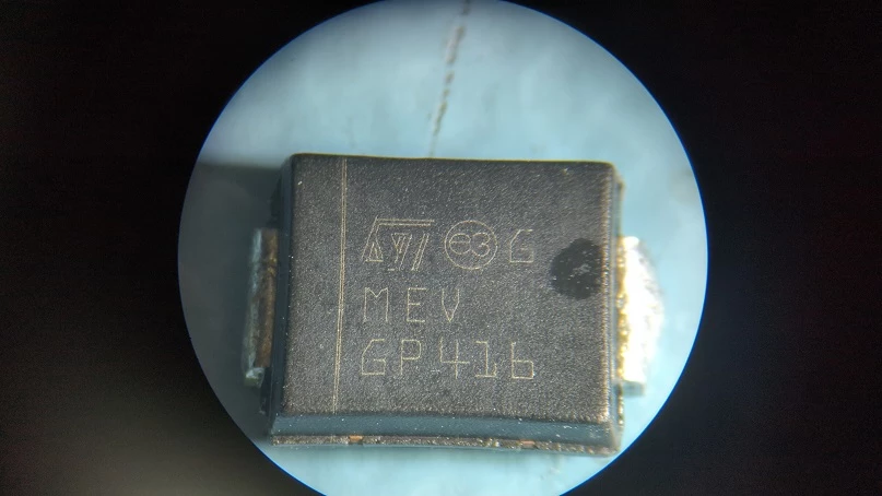

Hey all,
I'm trying to locate the datasheet of the following device:
I think that it is a Zener, but I am not 100% sure.
I've done the usual "Google" for the text, but I can't seem to find it.
Thanks in advance.

Peter BENSCH
February 10, 2025
Welcome @BatuKhan, to the community!
the marking MEV stands for the SM15T36A.
Hope that helps?
Regards
/Peter
