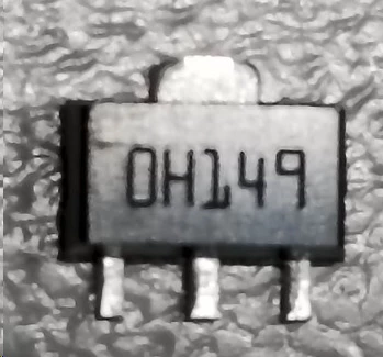

Hello, please help me identify the name of the chip. How can this procedure be carried out on your official website?

    The device in question is in a SOT-89 package, 0H denotes the LD2981CU33 and 149 the date code (YWW). Typically, the marking is also printed on the label of the bag, in this case the marking 0H (Zero-H).
    Does it answer your question?

    Apr 27, 2022 1:24 PM UTC
    Oh yeah. Thank you, Peter, very much . Helped me a lot.
