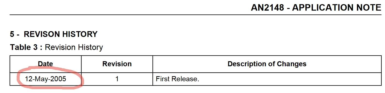

Please update information about STMPS2151 on https://www.st.com/en/switches-and-multiplexers/stmps2151.html#documentation
This is "AN2148 STOTG04 IN AUDIO CARKIT ENVIRONMENT" But inside pdf there is
0693W00000GZ8eXQAT.pngAlso there is no "STMPS2151" text inside AN2148. May be this application note isn't about STMPS2151?

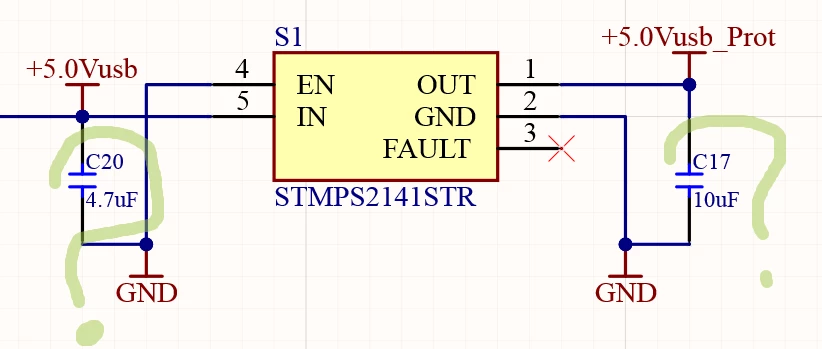

ALso I suggest add typical schematic on DS5410 Enhanced single channel power switches For example I don't know should I use capasitor on In and OUT pins?
