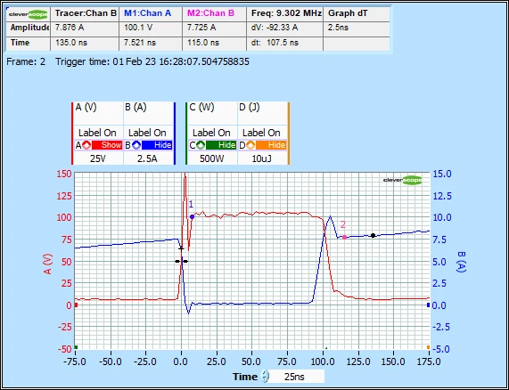

Hello I intend to incorporate MASTERGAN1 switching at 1.000MHz with duty cycle control How well MASTERGAN1 behave at 1MHz?

Hello
as a resonance converter switching at 1.000MHz with duty cycle control from 20% to 50% [ symmetrical]
HV <=40VDC Output power up to 40Watts
How well the MASTERGAN1 behave at 1MHz?
Compared with TI LMG5200?
Thanks

    I'm just using the evalmastergan1 board to do some double pulse tests. Working fine with 100ns pulses at 100V 8A, so I don't see a problem at 1MHz 40W.
