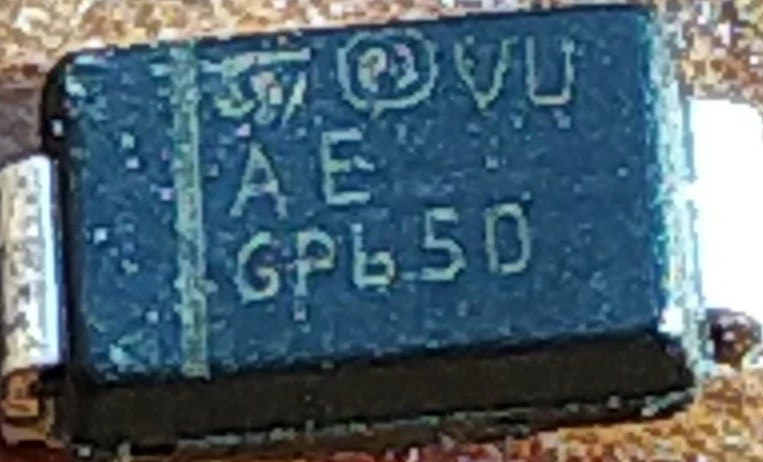

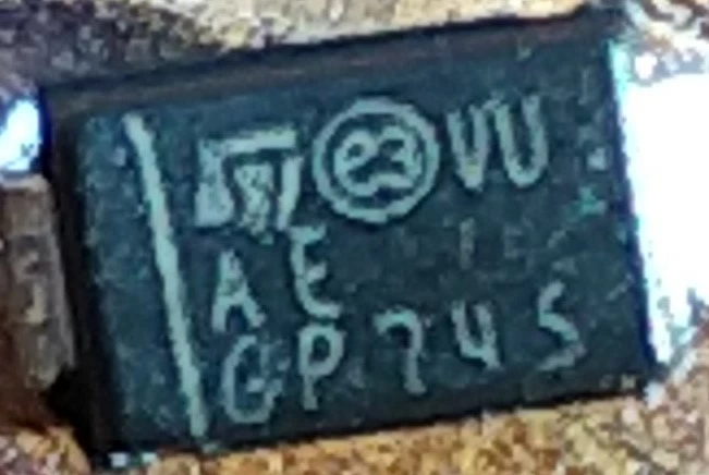

Hello, can anyone give me information about the SMD components in the photos? They should be: ST GP650 and ST GP745. Thank you.

What you have mentioned are the date codes, which is written in the 3rd row.
The part number is coded in the middle row, here "AE", which corresponds to SMAJ5.0A
Good luck!
/Peter

Is there a public database for marking smd components?
Thank you very much.
