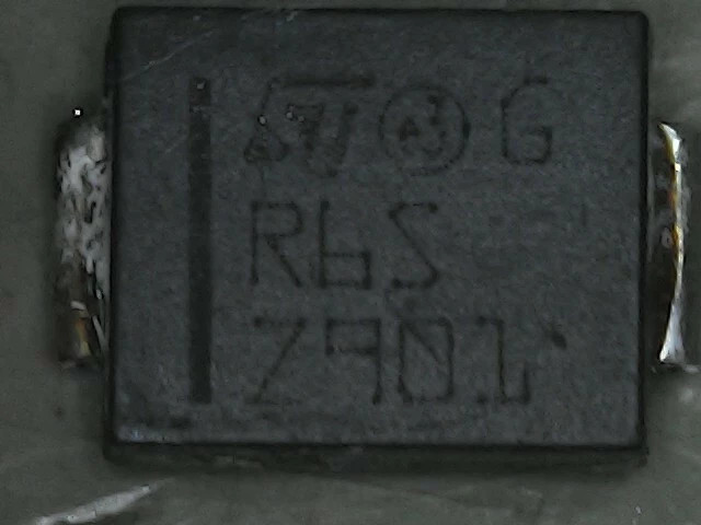

Find out component partnumber
I need a help to find out which partnumber matches the diode below:

Welcome ​@AlexSander, to the community!
the marking R6S stands for the STTH3R06S in the package variant SMC.
Hope that helps?
