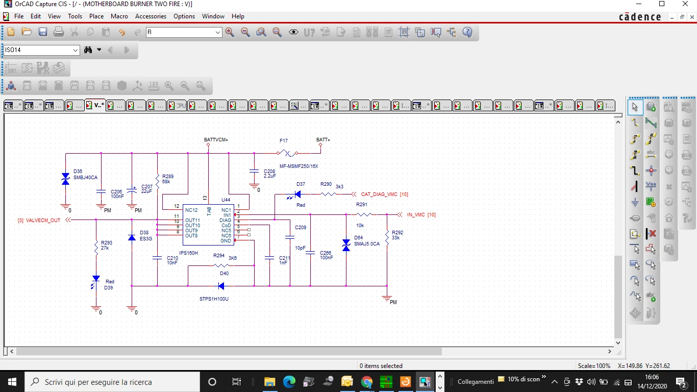

apenn.13
apenn.13Author
Dec 10, 2020 9:51 AM UTC
HI,
I STILL HAVE PROBLEMS.
I HAVE MODIFIED THE CIRCUIT AS IN THE ATTACHMENT, BUT IN THE PRESENCE OF SPARKS THE COMPONENT BREAKS.
IN PARTICULAR IN CORRESPONDENCE OF PIN 7 EVEN IF THERE IS NO LOAD OUTPUT (OPEN)
WHAT SHOULD I DO AGAIN?

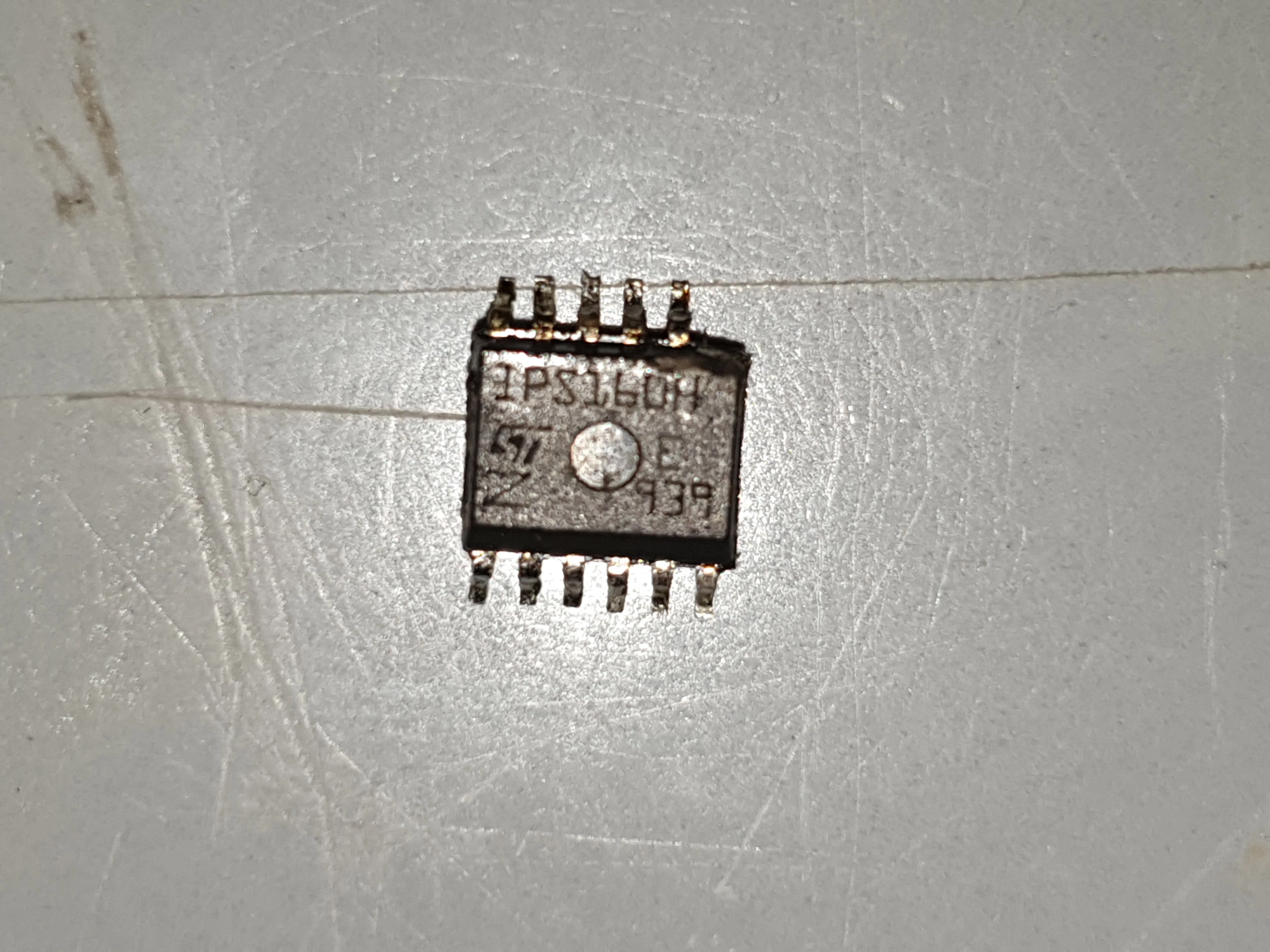

Domenico RAGONESE
Dec 10, 2020 10:13 AM UTC
@apenn.13​ .
We need to investigate even deeper:
1) can you send me a picture of the damaged IC?
2) Do you have the possibility to monitor the voltage between Vcc and GND (e.g. pins 1 and 7) during the spike?
3) Could you re-do the same acquisition, but with a short in paralle to R275 (and D24)?
4) Could you share the layout of your pcb?
I want to check the Vcc path and the position of the TVS D16.
Thank you in advance.
Best regards,
Domenico.

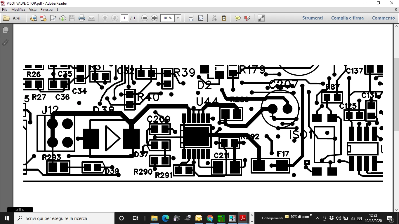

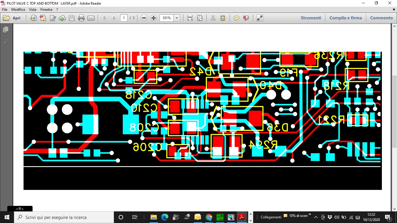

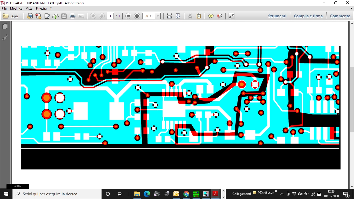

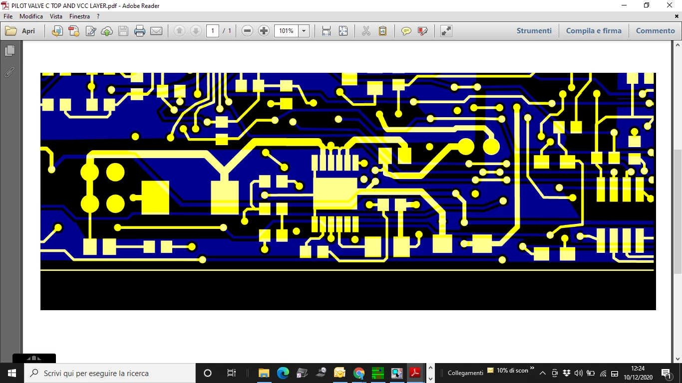

apenn.13
apenn.13Author
Dec 10, 2020 1:54 PM UTC
PIN 7 REMOVED WITH THE BREAKAGE OF THE COMPONENT
BROKEN
0693W000006FIOeQAO.jpgI HAVE ALREADY DONE THE TEST TO SHORT CIRCUIT THE RESISTANCE AND THE DIODE, BUT I HAD THE SAME RESULT
I ATTACH VIDEO WITH SPARK . THE YELLOW TRACE IS VOUT.THE BLUE TRACE IS VIN. THE SCALE IS 20VOLTS.
TOP AND GND LAYER ( THIRD IPS160H ON SCHEMATIC )
0693W000006FI8WQAW.pngTOP LAYER0693W000006FI0TQAW.pngTOP AND BOTTOM LAYER
0693W000006FI8CQAW.pngTOP AND VCC LAYER
Domenico RAGONESE
Dec 14, 2020 2:11 PM UTC
@apenn.13​
I've checked the layout and I can see many potential dangerous path from supply rail to Vcc pin of the IPS160H.
Similarly on the ground path, too.
Before to spend time (and money) on a new layout I'd try with some hand patches:
  • maintain SMJ40CA as TVS
  • maintain the short in parallel to reverse polarity protection diode
  • connect by a short wire C207(+) directly to Vcc pin (#1 or #12) of IPS160H.
  • connect by a short wire C207(-) directly to GND pin (#7) of IPS160H.
  • do the same for C206(+), C206(-) and C208(+) and C208(-)
The actions above purposes to reduce the parasitic effects on Vcc and ground nets due to many vias on the route to IPS160H.
It would be appreciated If you can capture the waveform between Vcc and GND (shortest path as possible from IC pins) to see if any improvement is visible: we must exclude that the IC is destroyed for the activation of the internal clamp between Vcc and GND).
Hope it helps.
Best regards,
Domenico.

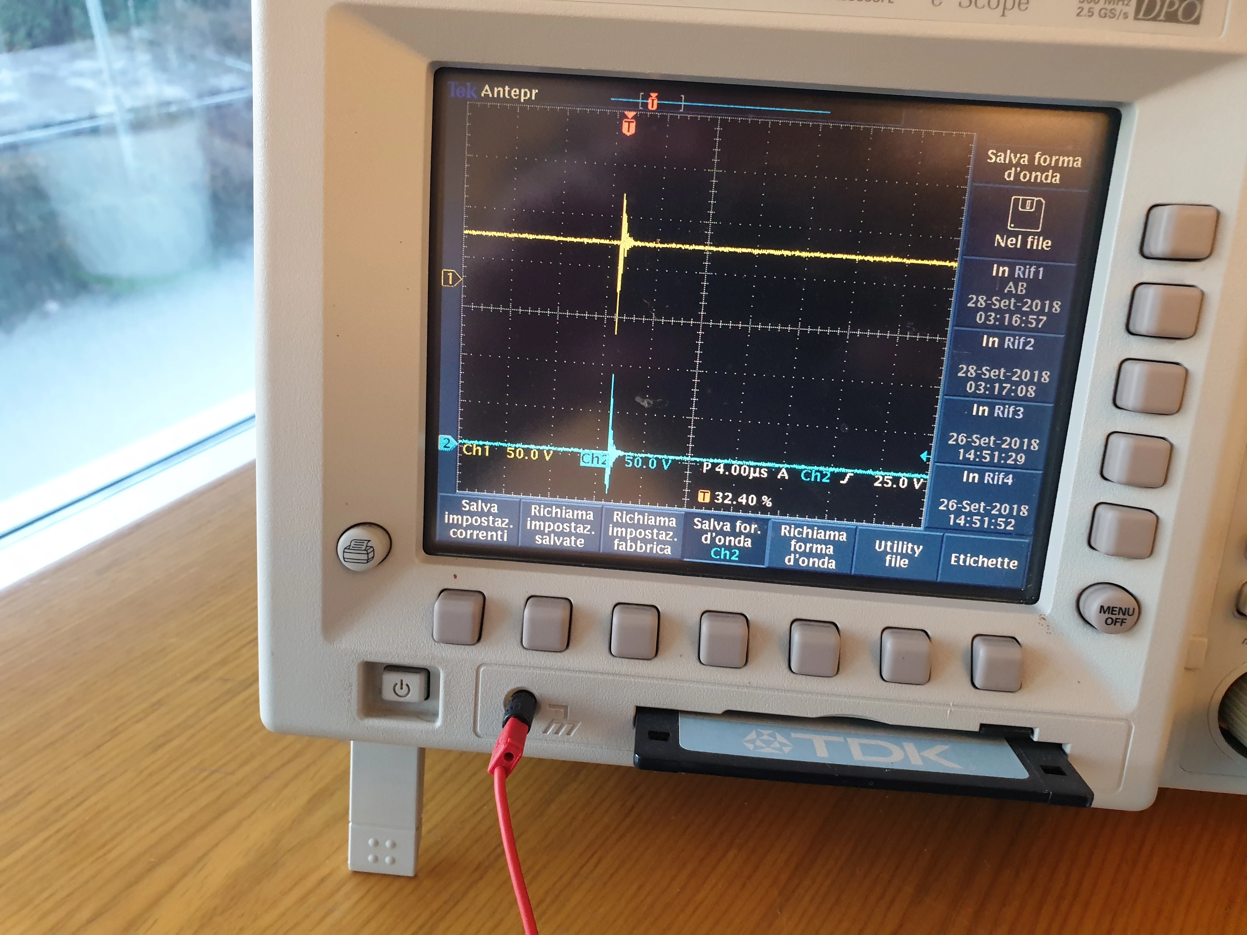

apenn.13
apenn.13Author
Dec 14, 2020 4:13 PM UTC
I HAVE MADE THE CHANGES YOU TOLD ME AS IN THE FIGURE RESISTANCE OF 10K AND 100nF INPUT CAPACITOR TVS IN SMAJ5.0CA INPUT SINCE I SEND A 5V IN INPUT INSTEAD OF THE 48 TVS ON VCC 40V
IN THE PRESENCE OF THE SPARK IN THE AIR I HAVE ON OSCILLOSCOPE THE VOLTAGES ON VIN (BLUE) AND ON VCC (YELLOW) HIGH EVEN IF FOR A FEW USEC.
THE VIN IS 5V AND IC IS ACTIVE WITH 48V ON VALVE.
CAN THESE VALUES BREAK FOR THE COMPONENT?
WHY DON'T TVS FLAT THESE VOLTAGES?
THE PROJECT IS VERY IMPORTANT AND THE PRODUCTION HAS HIGH NUMBERS (250,000 YEARS)
apenn.13
apenn.13Author
Dec 14, 2020 3:19 PM UTC
I HAVE MADE THE CHANGES YOU TOLD ME AS IN THE FIGURE BELOW
0693W000006FgHIQA0.pngI HAVE MADE THE CHANGES YOU TOLD ME AS IN THE FIGURE BELOW
RESISTANCE OF 10K AND INPUT CAPACITOR 100nF
TVS ON VCC 40V
IN THE PRESENCE OF THE SPARK IN THE AIR I HAVE THE VOLTAGES ON VIN (BLUE) AND ON VCC (YELLOW) HIGH EVEN IF FOR A FEW USEC.
THIS PROJECT IS VERY IMPORTANT AND THE PRODUCTION HAS HIGH NUMBERS (250,000 YEARS)
THANK YOU
A.PENNA
Domenico RAGONESE
Dec 14, 2020 5:21 PM UTC
@apenn.13​
The noise seems very fast (<1us) and it could be too fast for a TVS.
Could you send me a picture of the board (including the probe of the oscilloscope)?
It's not clear to me if you have implemented the following hand patches:
  1. maintain the short in parallel to reverse polarity protection diode
  2. connect by a short wire C207(+) directly to Vcc pin (#1 or #12) of IPS160H.
  3. connect by a short wire C207(-) directly to GND pin (#7) of IPS160H.
  4. do the same for C206(+), C206(-) and C208(+) and C208(-)
Alternatively to (2), (3) and (4) you could try by soldering a ceramic capacitor directly on pins 12 and 7 of IPS160H.
Best regards,
Domenico.
