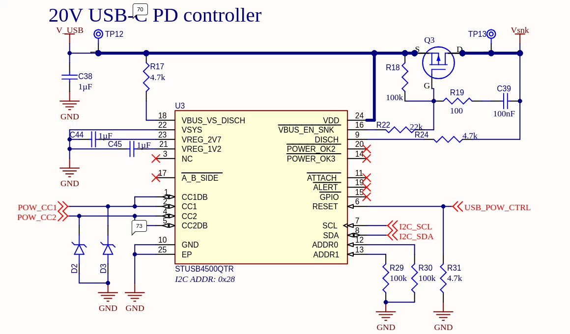

Hey,
I am having a big issue with ESD discharges and the STUSB4500. Essentially, I auto negotiate to 20V, and on ESD discharge, the STUSB shuts off VBUS_EN_SINK, while the supply continues to supply 20V. My thought is that on ESD discharge, the chip for some reason thinks it has had a disconnect event, waits for the supply to recover to 5V, but the cable has not been disconnected so continues to supply VBUS with 20V, and the STUSB then is in a hard stuck state until actual unplug and re-plug. There is no error seen, as GPIO does not pull low and is configured to show error states.
I cannot find a document that exposes all of the register values, but after every shut down, the chip register state reads the same failure state. The dump is as below.

The schematic almost follows the reference design to a tee with a single stage turn-on. I have swapped R17 and R24 with 1ks, and have also tested a reworked version of my board with the actual reference design filtering on VBUS_VS_DISCH (shown in the image below the schematic). The issues manifest on all reworks the same way.
Some advice would be very much appreciated. I know that it possibly has to do with routing, so I can supply some routing snippets if needed, but some help thinking about the setup of this chip a little better, or some insight on register value meaning, would help a lot. If there is a register I am missing or something hardware wise in the schematic you could see causing issues, please let me know.

I can not see any ESD protection on VBUS, maybe it is on another part of the schematics..
I recommend adding ESDA25P35 (https://www.st.com/en/protections-and-emi-filters/esda25p35-1u1m.html) close to the USB-C connector as in our eval kit schematics : https://www.st.com/resource/en/schematic_pack/steval-isc005v1_schematic.pdf
For CC lines protection, ESDA25W is recommended (maybe D2 and D3 have similar performances).
Let us know if it improves your issue.

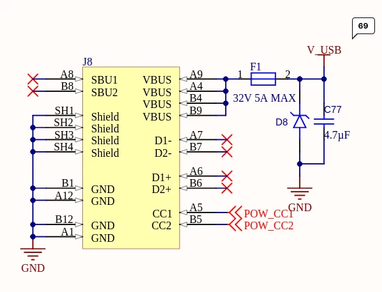

teton_bAuthor
August 27, 2026
Makes sense, I didn’t show the USB-C port schematic I realize, but I do have the ESDA25P35 on the board close to the USB-C. I have attached a screenshot.
For D8, it is the ESDA25P35-1U1M. Actually, this is the part on D1 and D2 too. Why do you recommend the ESDA25W on the CC lines specifically vs the P35? Thanks!
Didier HERROUIN
September 4, 2026
The protections you have placed in your schematics are fine. You may double the protection just for testing, but normally, it should pass ESD tests.
The circuit on VBUS_VS_DISCH is recommended to avoid unwanted reset in case of VBUS short drop voltage.
Which kind of ESD do you apply ?
Are you able to add a pull-up on ALERT and ATTACH pin so that you can monitor their level when the problem occurs ?

The ESD may trigger the reset of the chipset, which enters in recovery mode.
Please connect RESET pin directly to GND (instead of a 4.7k pull-down), it is a reliable protection against spurious. If you really want to keep a way to control the reset from your host, you can decrease this 4.7k value (to 1k or lower) and add a 100nF filtering capacitor in parallel.
