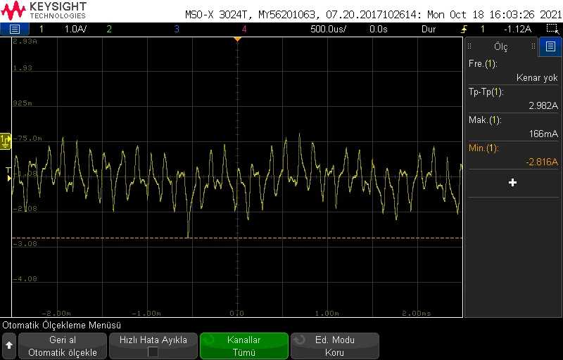

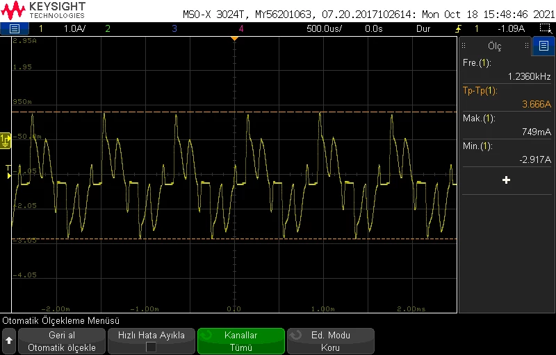

VinsmokeSanji
Nov 1, 2021 12:33 PM UTC
Hi Cristiana,
Based on our observations, supply voltage does not change. At the same environmental aspects, Air 40A ESC's noise is 86 dB and our ESC's noise is 92 dB. You can find motor phase and current signals files attached.0693W00000GW4mHQAT.jpg0693W00000GW4m7QAD.jpg0693W00000GW4lTQAT.png0693W00000GW4lOQAT.png

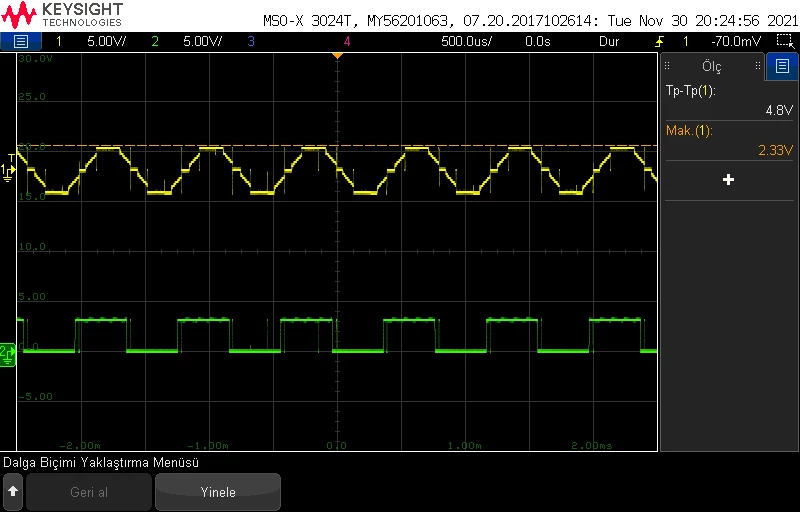

Cristiana SCARAMEL
Nov 3, 2021 10:37 AM UTC
Hi @Yasin Türk​,
please provide the above requested waveforms: one motor phase and respective Op Amp signals in the same screenshoot.

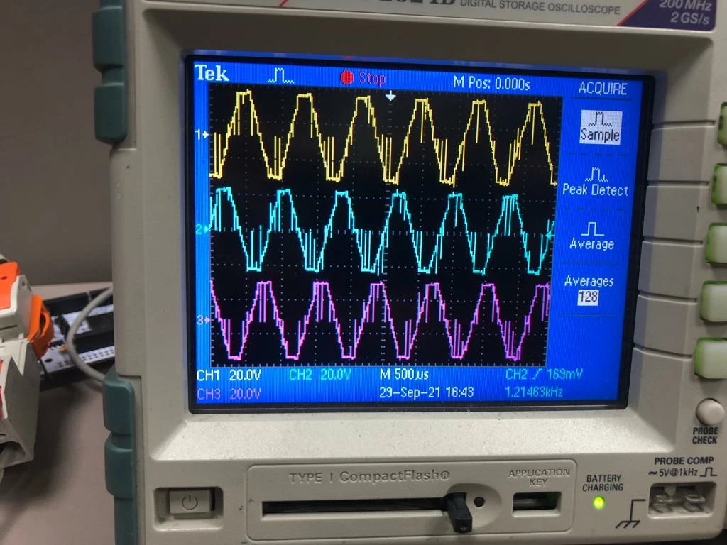

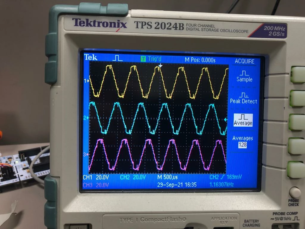

VinsmokeSanji
Nov 30, 2021 1:15 PM UTC
Hi Cristiana,
I am sorry about the late response. I added one motor phase and respective op-amp signals. Opbemf1 and Opbemf2 are signals at low speed. Opbemf3 and Opbemf4 are signals at maximum speed. Opbemf5 is also signal at maximum speed but voltage resolution is at 5V.
