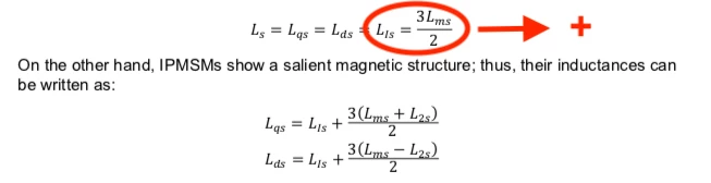

Error in UM1052 ?
  • May 1, 2019
  • 0 replies
  • 724 views
I wonder if the "=" should not be replaced with "+" in the equation below in UM1052, page 29. As I-PMSM equations are a generalization of this one for SM-PMSM, this should be a version of the later equations with L_{2S} = 0. Am I missing something?
