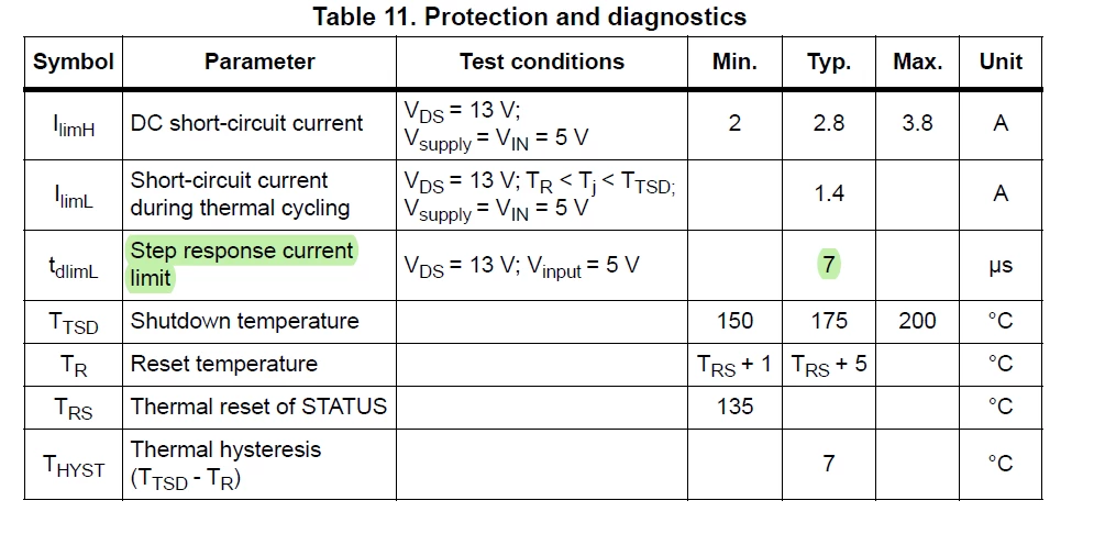

Driver IC VNLD5300TR-E _Delay time if Current trip happened
  • August 21, 2025
  • 0 replies
  • 1215 views
IC Part Number _ VNLD5300TR-E
Hi Team, we are using the above IC in our design. If a short circuit occurs and the current exceeds 2 A, how long will it take time for the IC to shut down?
