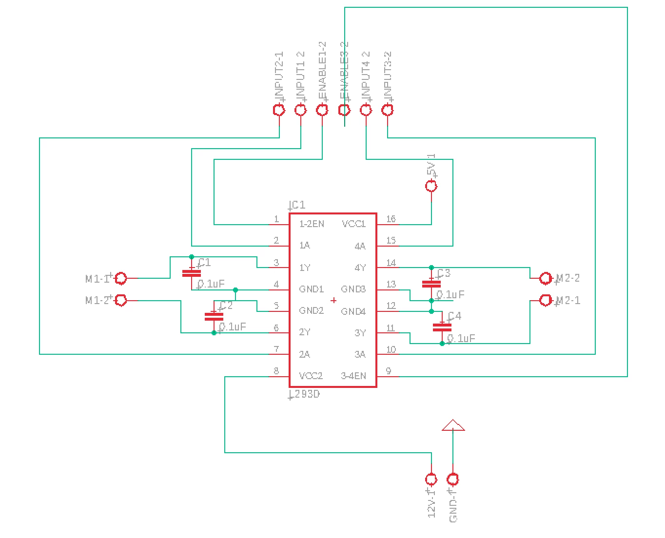

The input 1 and input2 signals will be fed from an STM32 but the problem is the signal sent from STM32 is 3.3V but the input to the IC is 5V. How do I convert the same? Please help.

Well, that good olde L293D.
This is a no brainer because even 3.3V supplied GPIO output generates 5V TTL compatible signal levels.
See data sheet of your chip.
Application note AN4899 "STM32 microcontroller GPIO hardware settings..." is worth reading.

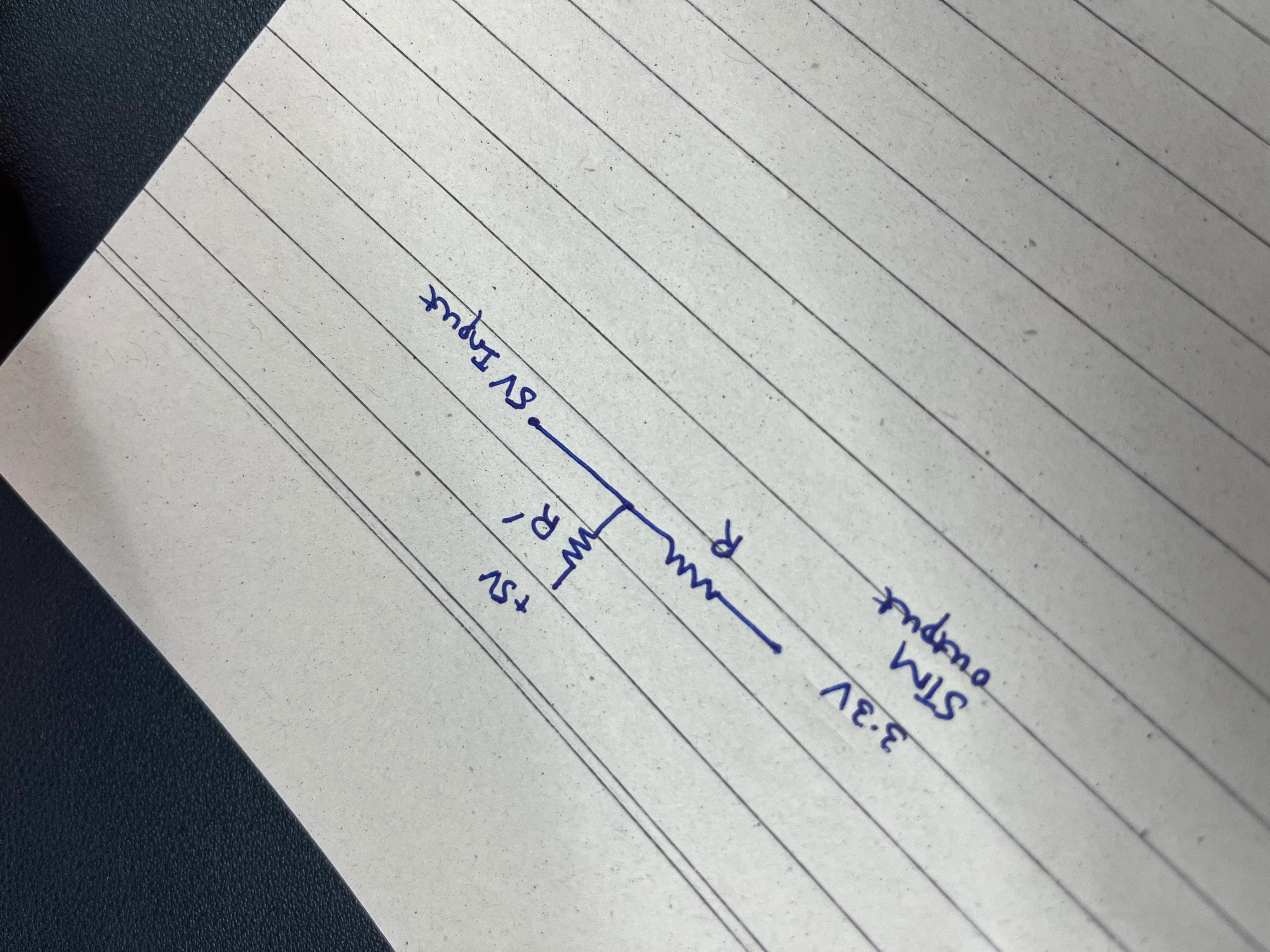

Killstreet30
Feb 14, 2023 3:40 PM UTC
I thought I'll use this circuit but how will I calculate the R and R' values? Any idea?

That way you build a voltage divider so that the input will never see neither 0 V nor 5 V.
So better check the datasheet what "5V input" means (high / low thresholds, min / max over complete temperature range), then you might find that what KnarfB said is correct.
The most simple level shifter would be putting a npn transistor (or N-mosfet) "between" your 2 resistors, although then you would have an inverted signal.
