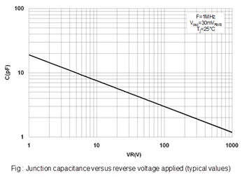

I am looking at using the STTH112RL diode in a gate drive circuit. I was trying to find the capacitance of the diode but it is not in the data sheet. Can you please send me that information?

Here is how the capacitance depends on reverse voltage applied:
