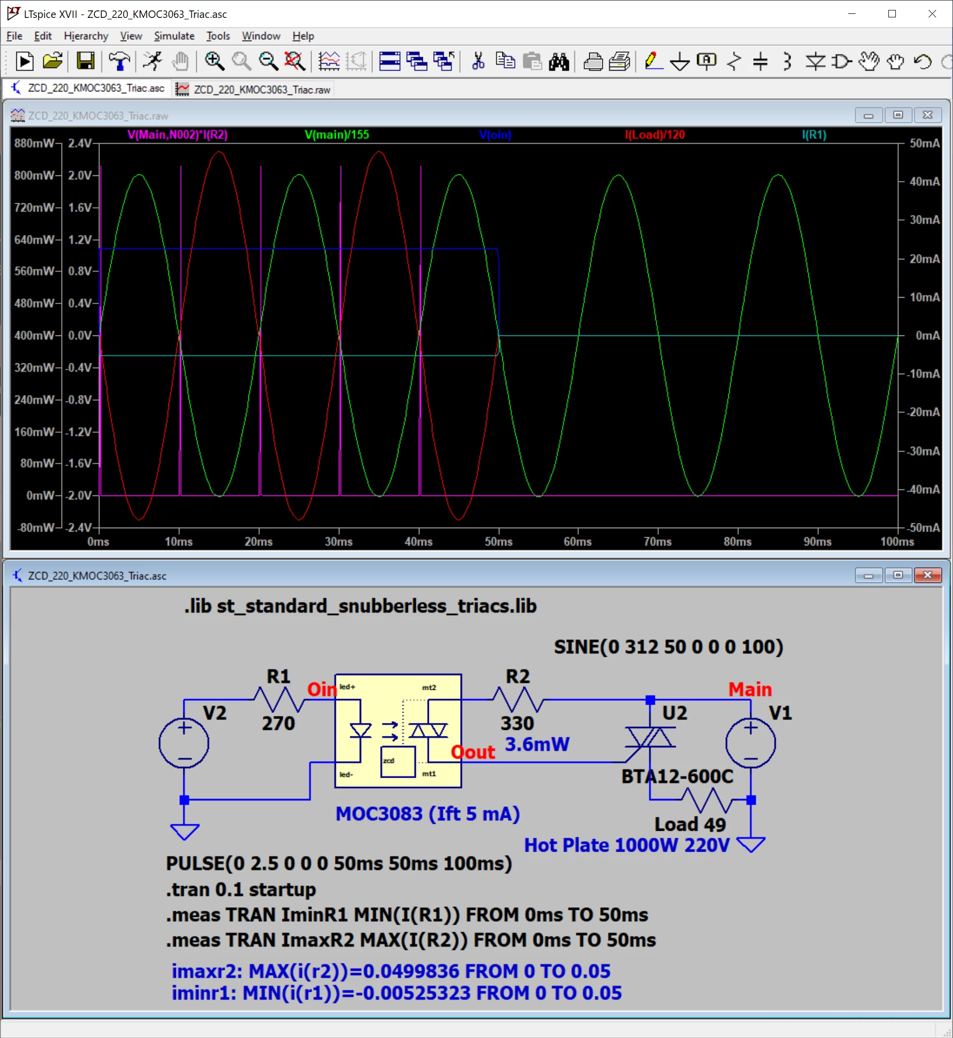

Design of ZCD TRIAC circuit
  • January 18, 2024
  • 0 replies
  • 970 views
I'm not sure if I've designed the circuit for PWM power control of the hot plate correctly. The PWM output is a 3.3V MCU. I assume the PWM period 200 ms. The hot plate is 1000W, 220V, 50Hz.
