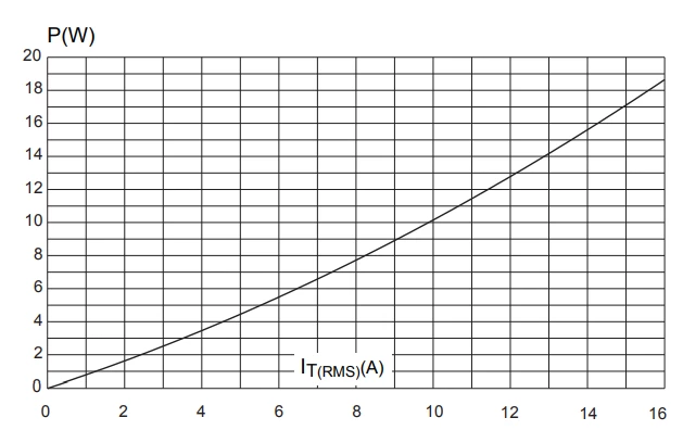

just from ds : T16xx :

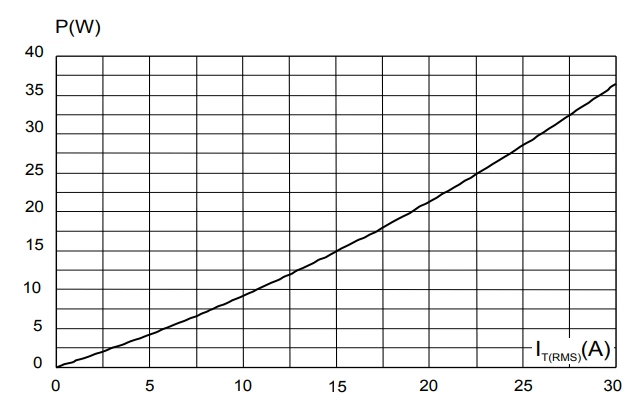

T30xx :
So at 16A : about 19W -> 16W dissipation with T16 -> T30 ; ( about 20% less , with T30 )

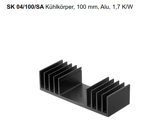

Here, with 16W loss and desired heat sink temp of about 60° C , at max. 30° ambient you need : (60-30)/16 = 1.8 °/W heat sink. (Or smaller heat sink with forced cooling, using a fan.)
Something like this : (100mm size)
And be aware : triac is not isolated, so need isolated mounting and thermal grease !
