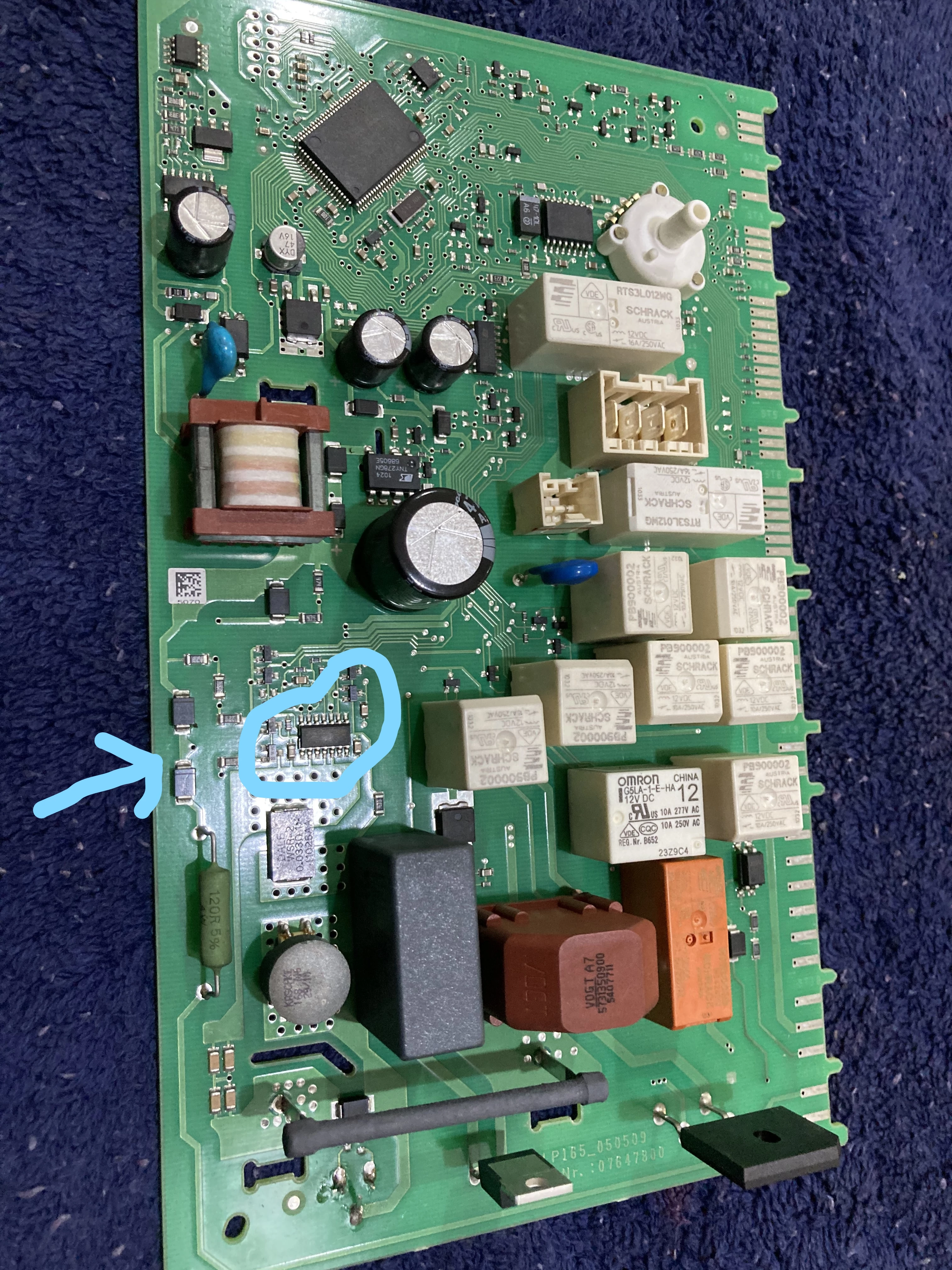

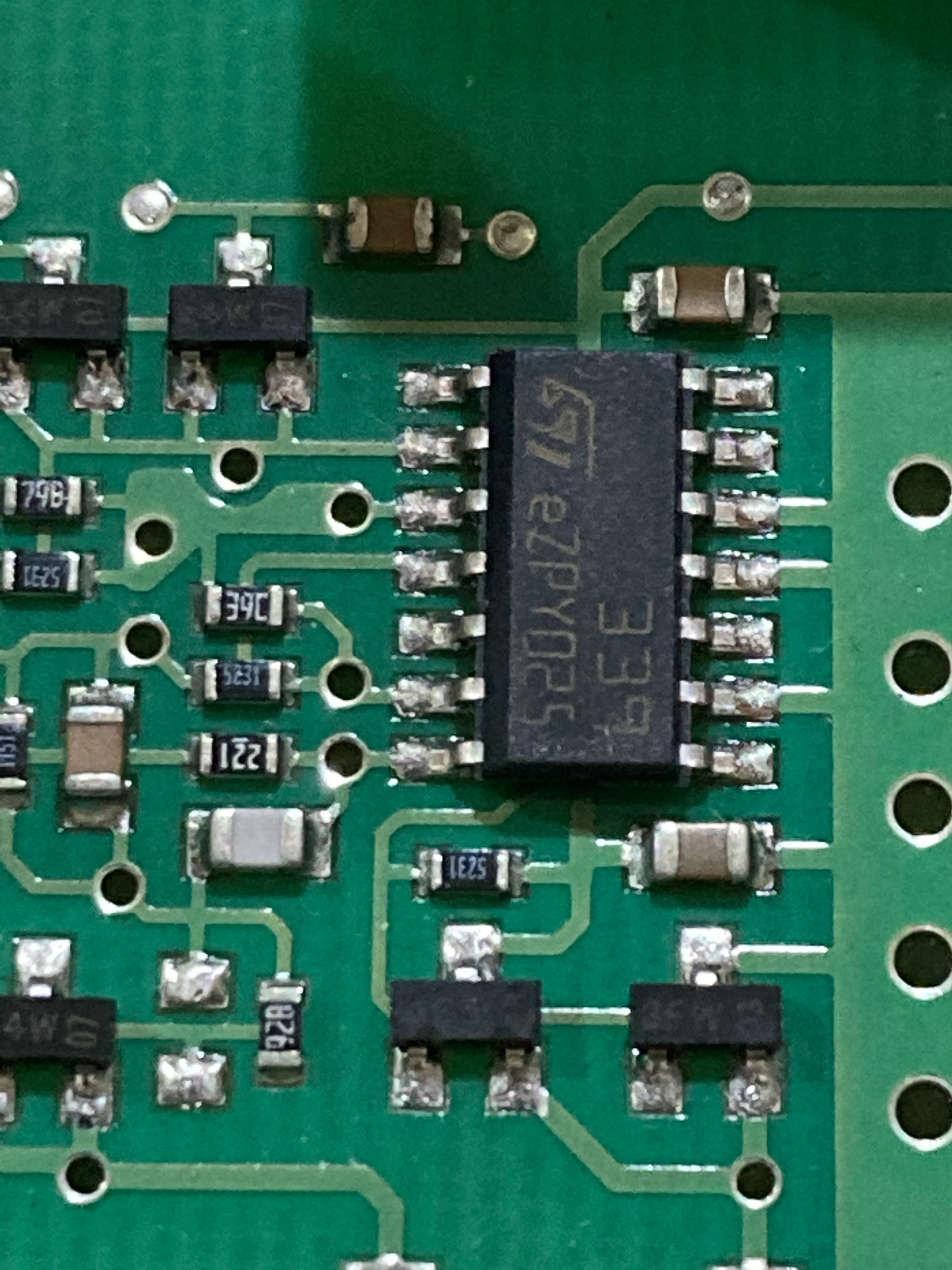

Can't find ST IC Soic-14 with : eZPY025, may be a PWM controler
Hay to everyone,
My name is Tony, live in Melbourne, Au.
I am fixing electronic boards for house appliance and often use ST products.
This time I need to replace a IC from ST with writing : eZPY025, I think is a 100KHz PWM controler. Can't find anywhere Data sheat for it or source to bay.
Hopping someone on Forum can help, thanks Tony.

    Tesla DeLorean
    Guru
    May 28, 2021 7:14 AM UTC
    Attach clear picture of device in circuit.​
    AToml.1
    AToml.1Author
    May 28, 2021 8:14 AM UTC
    0693W00000AQ94JQAT.jpg0693W00000AQ946QAD.jpgHi Tesla, thanks for fast replay, hope the pics will help, regards Tony.
    Uwe Bonnes
    Uwe BonnesBest answer
    Chief
    May 28, 2021 9:13 AM UTC
    That seems to be a LM339 Komparator.
    AToml.1
    AToml.1Author
    May 28, 2021 9:25 AM UTC
    Thanks Uwe, I will download Data sheat and compare.
