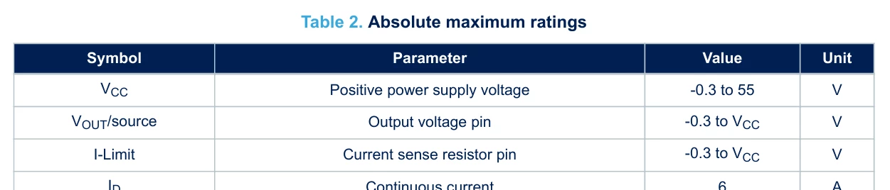

Can STEF01 handle negative transients (350 ms) of -40 Volt?
we want to know that. Can this IC E-Fuse capable to handle negative transients (350 ms) of -40 Volt.
Please Reply ASAP.
MPN: STEF01

Sep 16, 2025 2:13 PM UTC
On the output pin? The output pin is limited to -0.3 V. -40 V is far outside of these bounds. Operation outside of the absolute maximum ratings is not guaranteed.
Andrew Neil
Sep 16, 2025 2:18 PM UTC
Indeed.
@PradipRaj Worse than that - operation beyond the Absolute Maxima may cause damage:
Sep 16, 2025 2:44 PM UTC
And in this case, will almost certainly cause damage.
The -0.3 V limit suggests protection diodes. When you try to pull a net to - 40 V, those diodes will activate and try to bring VSS to - 40 V. That in turn will almost assuredly bring other rails down.
Peter BENSCH
Peter BENSCHBest answer
Sep 16, 2025 7:26 PM UTC
@PradipRaj
If you are asking about a possible negative input voltage: reverse polarity protection is required for this, e.g. with a p-channel MOSFET and at -40V also a TVS or zener to limit the voltage to the maximum gate voltage. Such reverse polarity protection blocks the negative voltage and thus prevents the destruction of the downstream components, in this case the STEF01.
