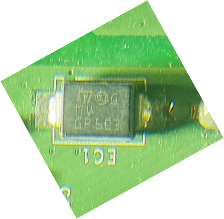

Can anyone help me indentify what is this compononet? GMVGP603 Follow a image of it

    The device type marking is MV, which stands for the 600W TVS SM6T36CA.

    Thank you so much Peter!!!​
