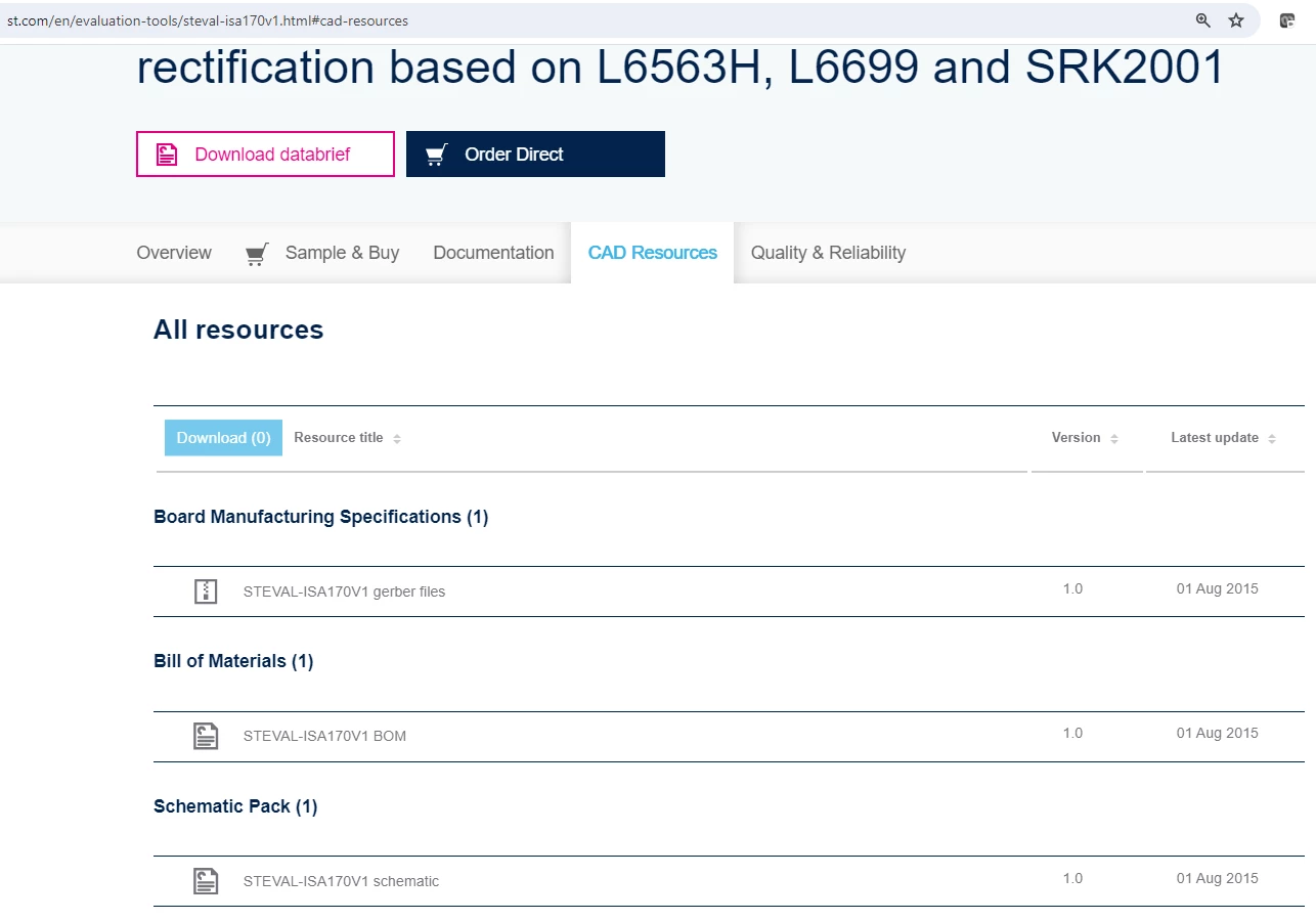

I can't see a Product Page for "steval-1sa170v1" - can you give a link?
Jan 24, 2024 10:37 AM UTC
Andrew Neil
Jan 24, 2024 10:53 AM UTC
Thanks.

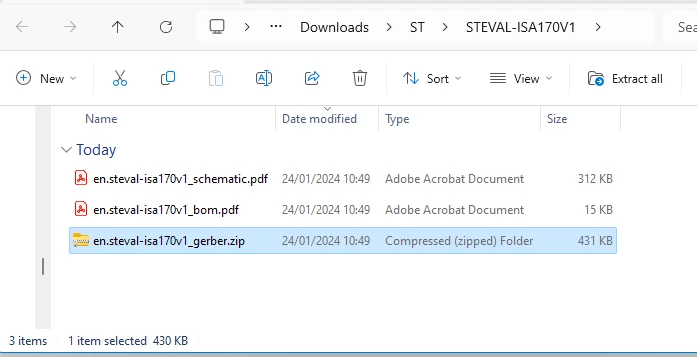

So I see Gerbers, BoM, and Schematics all available for download there:
The Gerbers download as a Zip; the BoM and Schematics as PDFs:

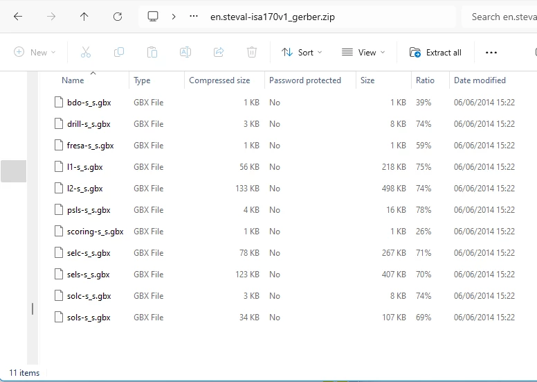

Inside the Gerbers Zip:
Jan 24, 2024 11:43 AM UTC
i couldn't open the gerber files. so i asked for the layout or what is the method to open it?
Peter BENSCH
Jan 24, 2024 12:23 PM UTC
Well, GERBER data is actually only intended for plotting a layout or producing a board, similar to PDF, which is also only intended for printing and not for re-layouting. However, you can use a GERBER viewer to orientate yourself on details from its data and derive your own layout. There are GERBER viewers that you can use for free, e.g. the one in the KiCAD package.
