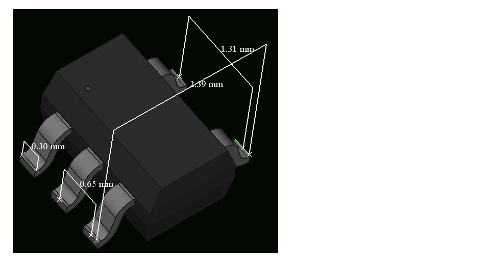

Are the STEP files for the LDK220 LDO voltage regulator that are posted correct?
  • July 21, 2021
  • 1031 views
The datasheets states a device package of SOT23-5L. It states a pitch of 0.95 mm. However, when I downloaded the LDK220 SOT23-5L step file, the measured pitch is 0.65 mm. So, before I incorporate this device into my design, can someone please clarify which is correct. Is the datasheet correct or is the step file correct? I have attached a screenshot of some step file measurements.

    Welcome, @ST_InquirePower​, to the community!
    The LDK220 is available in the packages SOT-89, DFN6, SOT23-5L and SOT323-5L.
    • SOT23-5L: 0.95mm pitch, body length 2.95mm
    • SOT323-5L: 0.65mm pitch, body length 2mm
    For whatever reason you've got the STEP file of the SOT323-5L, maybe it's a mistake by the external company providing the STEP files.
    Regards
    /Peter

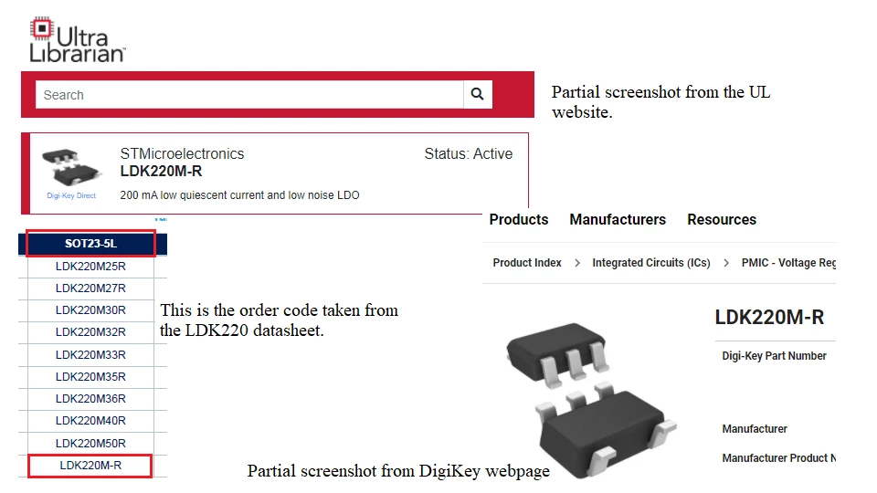

    ST_InquirePower
    July 22, 2021
    Thank you for your reply. It appears that Ultra Librarian has the wrong step file for this device. I had actually clicked on the device step file link at the bottom of the DigiKey webpage. It took me straight to the Ultra Library webpage. In the sketch that I attached, it shows the order code for the LDK220 LDO for the adjustable version with an SOT23-5L footprint taken from the datasheet on page 25, section 8. I also took a screenshot of the UL and DigiKey webpages as additional confirmation.
