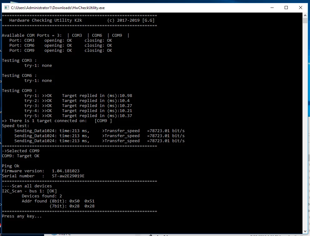

Always get STUSB4500 Not Detected message when using NVM GUI
I have checked and re-checked this. Also used another USB to I2C converter and can read the registers just fine. Put an I2C analyzer on the setup and I see no activity when the GUI program starts.
Today on Github I found a HwCheckUtility.exe file. It launches, finds the com port and then indicates it found the I2C device at 0x28 address. I also see the scan on the logic analyzer.
I am now at a loss as to what do next.

There is a known issue with the GUI on some computer configuration with several COM ports, where the port on which is connected the Nucleo board is not detected automatically.
Please use the updated version attached. It should resolve the port detection.
Check also that you have VC++ 2015 runtime properly installed.
Prerequisites for STUSBxx GUI:
• 1) On Windows 7, install: STM32 Virtual COM Port Driver (STSW-STM32102)
  http://www.st.com/en/development-tools/stsw-stm32102.html
On Windows 10, no need to install additional drivers, because the USB CDC driver is already installed by default.
• 2) Install: Microsoft Visual C++ 2015 Redistributable Update 3
  https://www.microsoft.com/en-us/download/details.aspx?id=53587

Thank you for the new GUI. I used the latest one and it is now talking to the development board. So it looks like my problem is solved.
NOTE: On my Lenovo laptop (WIN 10), I had to install the 32 bit Microsoft Visual C++ 2015 Redistributable Update 3. Even though this is a 64 bit laptop, it wanted the 32 bit dll. No problem, it works which is all I want.
