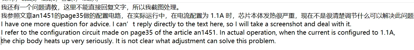

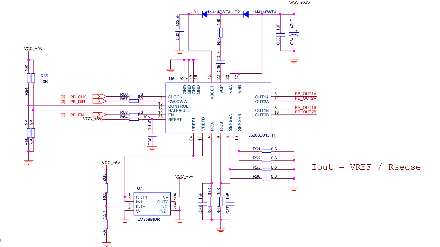

After L6208 configures the circuit according to the manual, the chip is easy to heat up

Hi @Wyoun.1​,
the circuit at page 35 of application notes AN1451 is related to a package option no more available.
Are you using the L6208PD (PowerSO36) or L6208D (SO-24) option?
Could you share your schematic with components value for a fast review?
Moreover, please give more details on the driving option: step mode (HALF/FULL pin status), decay mode (CONTROL pin status), voltage reference value.

Wyoun.1
Wyoun.1Author
Sep 2, 2021 1:16 AM UTC
I am using L6208D (SO-24)
Cristiana SCARAMEL
Sep 3, 2021 8:25 AM UTC
Hi @Wyoun.1​ ,
ok for L6208D.
What about the others questions?
  • Schematic with components value
  • Details of driving: : step mode (HALF/FULL pin status), decay mode (CONTROL pin status), voltage reference value
Please provide more application details.

Wyoun.1
Wyoun.1Author
Sep 7, 2021 6:01 AM UTC
Step mode : HALF , Slow decay mode
