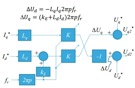

The feedforward control block diagram in the official data is as follows:
However, the calculation result in FF_VqdffComputation is different, taking ΔUq as an example.
ΔUq = (Ke + Ld*Id)*2*pi*p*fr + Uq
The code in FF_VqdffComputation is as follows:
/*q-axes ff voltage calculation */
 wtemp1 = ( ( ( int32_t )( hSpeed_dpp ) * Iqdref.qI_Component2 ) / ( int32_t )32768 );
 wtemp2 = ( wtemp1 * pHandle->wConstant_1D ) / ( int32_t )( hAvBusVoltage_d );
 wtemp2 *= ( int32_t )2;
 wtemp1 = ( ( pHandle->wConstant_2 * hSpeed_dpp ) / ( int32_t )hAvBusVoltage_d )
 * ( int32_t )16;
 wtemp2 = wtemp1 + wtemp2 + pHandle->VqdAvPIout.qV_Component1;
 SATURATION_TO_S16( wtemp2 )
 pHandle->Vqdff.qV_Component1 = ( int16_t )( wtemp2 );
Where pHandle->VqdAvPIout.qV_Component1 is the value of the Uq* filter in the block diagram.
When Uqd is corrected by feedforward control in the FF_VqdConditioning() function, Uq is added.
The code in FF_VqdConditioning is as follows
wtemp = ( int32_t )( Vqd.qV_Component1 ) + pHandle->Vqdff.qV_Component1;
Where Vqd is Uq*, Ud* in the block diagram
Please help me to confirm, is it my understanding of the error, or the code error?

Claire O.
March 29, 2019
Dear customer,
Thanks for pointing this difference.
We will check your findings with our experts and modify or the code/ or the docs.
Thanks,
Claire
