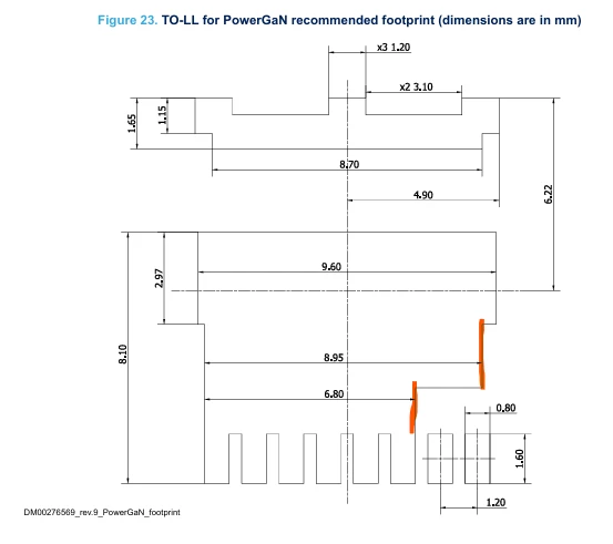

I saw the pad dimensions for the SGT070R70HTO listed in the datasheet.
But I don't know the dimensions of the parts I marked in red.
 So I want you to tell me that.
Thank you.

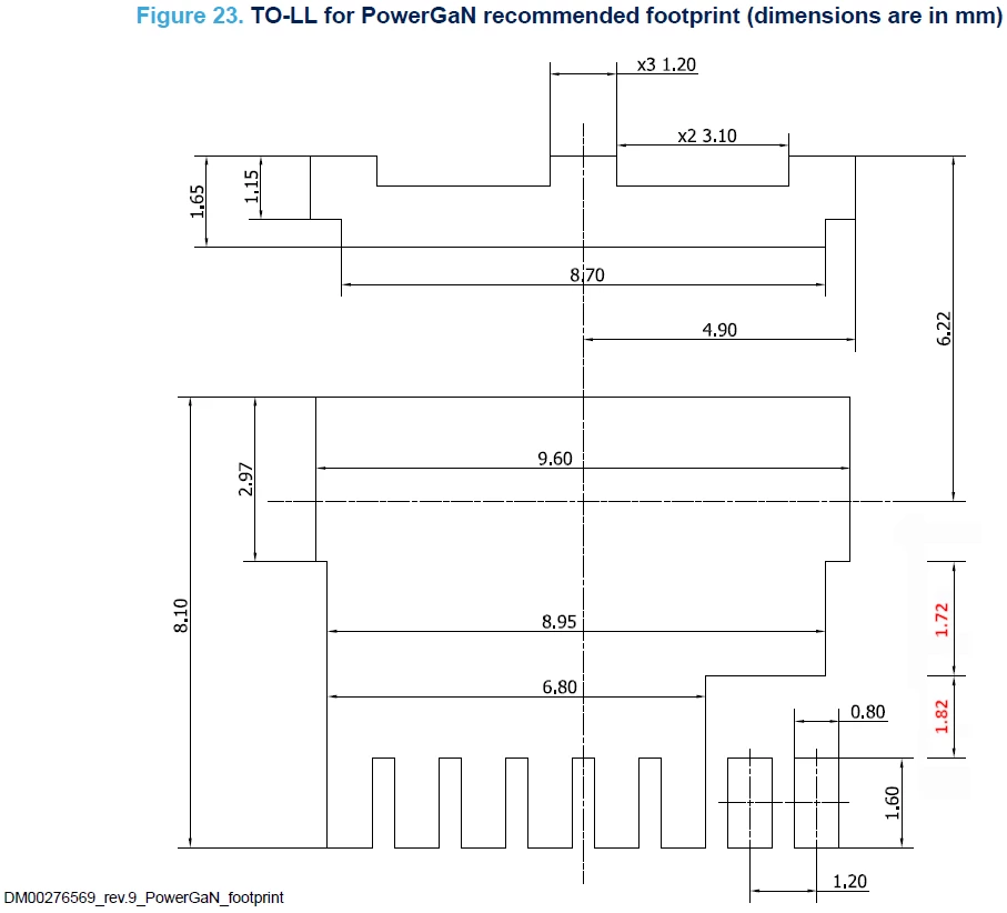

I’m very sorry that the package information in the datasheet of the SGT070R70HTO does not contain the complete data. However, you can determine it from the footprint in the CAD resources.
I’ve just done that and entered the two requested dimensions in red:
