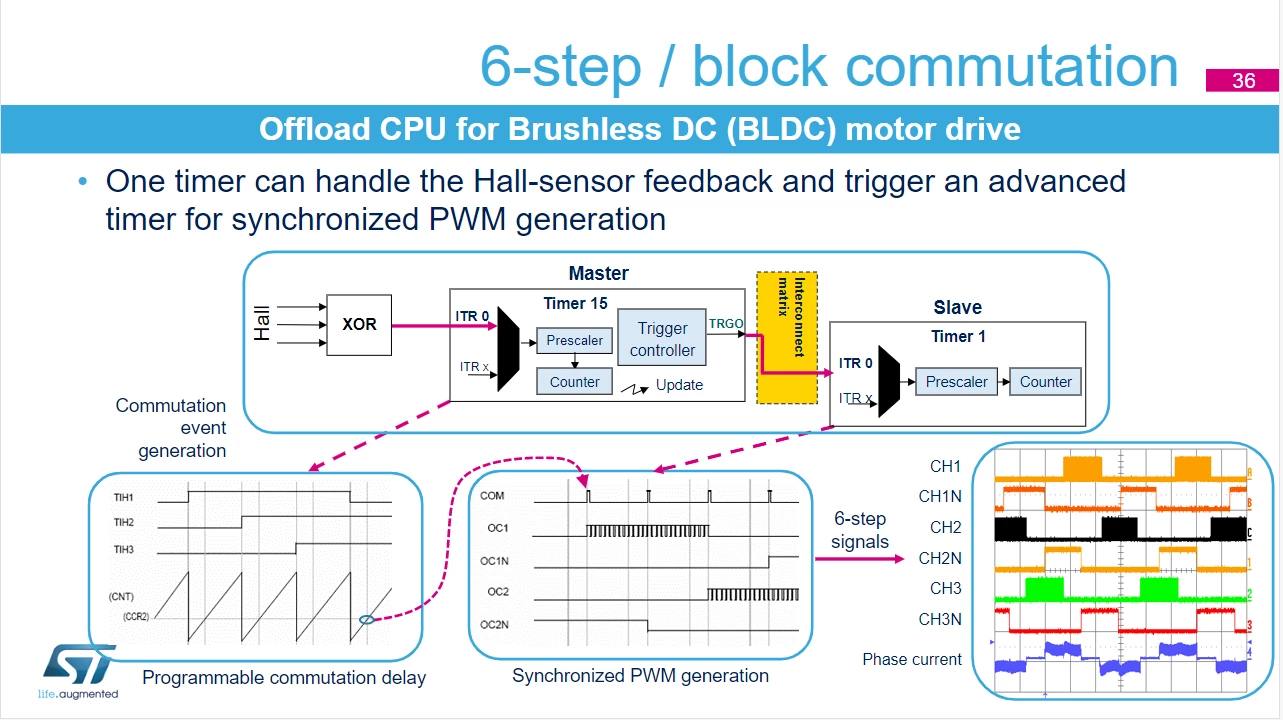

6 step drive with hall sensor interface
How to work on STM32 inbuilt 6 step drive with hall sensor interface.
Does anybody know any datasheet or reference manual for this?

Hi Karthik-san
I'm working on sensorless BLDC motor with Six Step control.
The application using the hall sensor seems to be as follows.
I think these application note and web site help you.
[Application Notes]
  • AN4013: STM32 cross-series timer over view
  • AN4776: General-purpose timer cookbook for STM32 microcontrollers, N-pulse waveform generation application example - part 2
[Web site]
