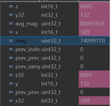

I work on an STM32F407G-DISC1 pedometer project, in which the program is supposed to use built-in lis3dsh accelerometer via SPI to detect and count steps and display the number of steps on the screen (ILI9341 SPI).
I have tested my screen code, and it works properly, so problem lies in how I use accelerometer or detect steps.
To detect steps, I read lis3dsh registers with 100HZ frequency by making a call to SPI from a 100HZ timer interrupt. These snippets are interrupt and timer configuration respectively.

 In the TxRx callback function, I compare the previous sample (each sample is sum of squared x/y/z values) with the one before it and the current sample. If the previous sample is greater than either of its to neighbors, greater than a cutoff (which is supposed to be 0.35g), and it has been between 20 and 90 samples since the last sample corresponding all these conditions (this condition performs as a filter), it gets counted as a step.

 I think that the problem is either in step detection logic, or lis3dsh initialization, but I am not sure what the root of the problem is exactly.
UPD: I have accidentally changed the code for the main function in this post to the newer one (I wanted to edit a comment instead)

Jan 31, 2026 10:23 AM UTC
Ok, I have got it working, It still misses some steps, though, but it should be easy to fix. To sum it up, the list of issues my previous versions had:

I have modified the code. I now get reasonable values from pedometer. I also smooth the input slightly by averaging it with the previous two samples. But it is still wrong. Maybe some constants like PEAK_CUTOFF are off (I approximated it as slightly less than base magnitude squared times 1.2^2, because this source says a step is movement with acceleration ~1.2 g “What Is a Step?” Differences in How a Step Is Detected among Three Popular Activity Monitors That Have Impacted Physical Activity Research - PMC).
These are the approximate values I get when the device is static.
This is the main function
