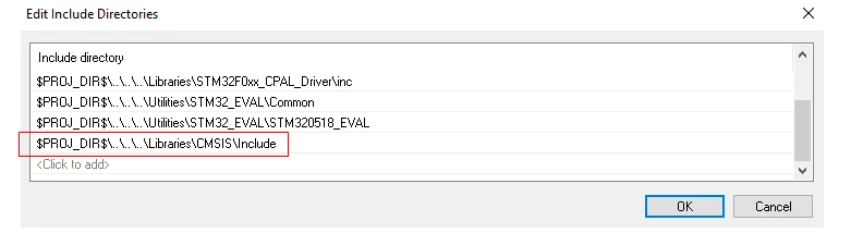

Use the latest version of IAR to compile the standard peripheral library, get some faults.
IAR version is 9.10.1, the lib version is 1.5.0 for F0 device. The IAR expose a lot of faults about "core_cm0.h". I do not change anything, just open the project file under "EWARM", then compile.

Hi @Xwang.4​ ,
In fact, this issue also appears when I used old release EWARM 8.50.6 and it’s caused by wrong path to core_cm0.h file.
Could you please try the following steps and let me know if that fixes your issue ?
  • Open the project template using EWARM v9.10.1
  • From project options -> C/C++ compiler add the following path:
\Project repository\STM32F0xx_StdPeriph_Lib_V1.5.0\Libraries\CMSIS\Include
  • Build the project
Note: the project in "STM32F0xx_StdPeriph_Lib_V1.5.0" package was developed using an old IDE version (EWARM V7.30.3)

Thanks, it can be compiled correctly.
