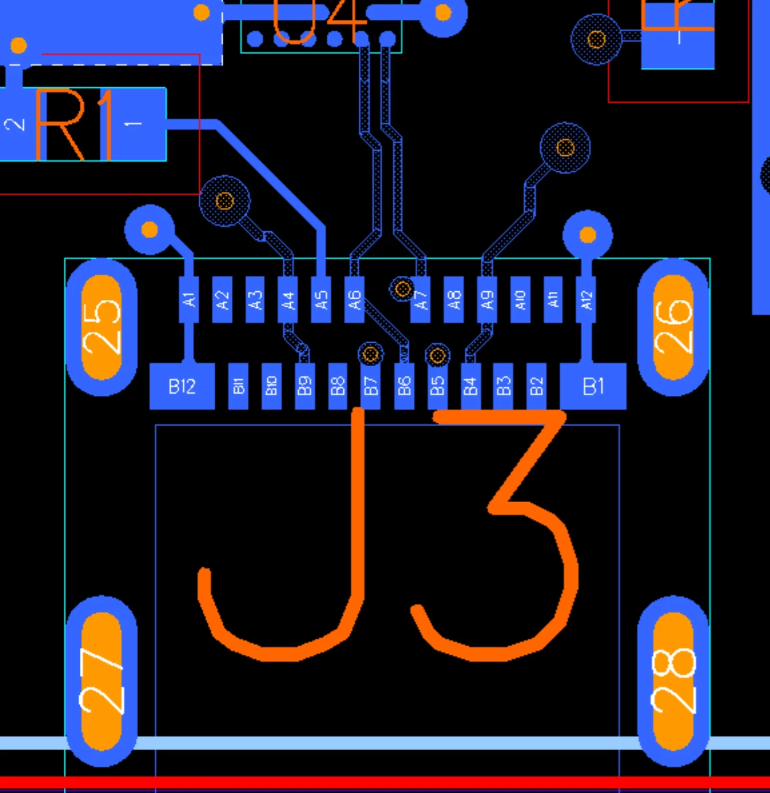

USB pins PA11, PA12 failing short during hot plugin of type C port on board(STM32H56V3G)
Hi ST Team,
In our design, the USB pin pairs from PA11, PA12 our failing short multiple times during hot plug in of type C port to power the board. The USB pin pairs does not directly go to type C port rather it goes through this chip PCMF3USB3S (ESD + EMI filter) from Nexperia. Currently we do not have any ESD protection on VBUS pin. The VBUS +5V currently generates 3.3VDD to power the STM32H56V3G on our board. There is also a diode as connected reverse b/w VBUS +5V and 3.3Vdd output as recommended in AN4899.
Can you please give us some insights on why this could be happening and what would be the possible solution

Refer to AN5225 "Introduction to USB Type-C® Power Delivery for STM32 MCUs and MPUs" for recommendations on USB Type-C protection, including ESD/EOS protection of VBUS.
October 21, 2026
What are PA11 and PA12 being shorted to? How did you determine that?
