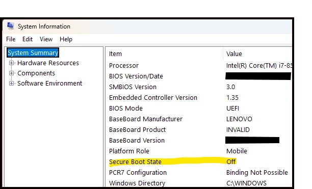

On the new PC, is secure boot enabled?
To install manually, you don't even need zadig. Just install the winusb driver from device manager.
> seems that the problem is related to host controller
Then try to plug the device thru a good USB 2.0 hub.
ZioGianniAuthor
April 16, 2025
Thank you Pavel for your answer.
I did a try also with secure boot disabled and with USB 2.0 hub but nothing change.
