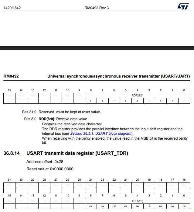

Bob S
Jan 2, 2026 1:26 PM UTC
How do you know the baud rate is correct?  Have you looked at the TX line with a scope?
I don't know specifically for the H5 for sure, but with other STM32 families, if you want to send 1 byte you need to write 1 byte, not a 32-bit value (which will actually send 2 bytes - in your code that would be 0x41 0x00, or the other way around, I don't recall).
How do you have USART2 connected to to your PC?  Is this a Nucleo board and USART2 is the port connected through the on-board STLink?
You can always use CubeMX to generate a simple program, or use one of the sample UART projects, run that and see what the register values are, then compare to your register values.
Andrew Neil
Jan 6, 2026 3:27 PM UTC
Well, the USART TDR register is a 32-bit register:
https://www.st.com/resource/en/reference_manual/rm0492-stm32h503-line-armbased-32bit-mcus-stmicroelectronics.pdf#page=1421
Bob S
Jan 9, 2026 5:43 AM UTC
Right-o, I was thinking of the SPI data registers, that can take 8/16/32 bit writes.
