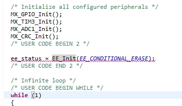

Hi all,
I'm trying to implement manually the ST EEPROM emulation package.
But I got stuck at a undefined reference:
I included in the right build paths and in the IDE I can perfectly jump to the EE_Init() function.
So the IDE does know where to look, but my compiler doesn't
What can be the problem here?

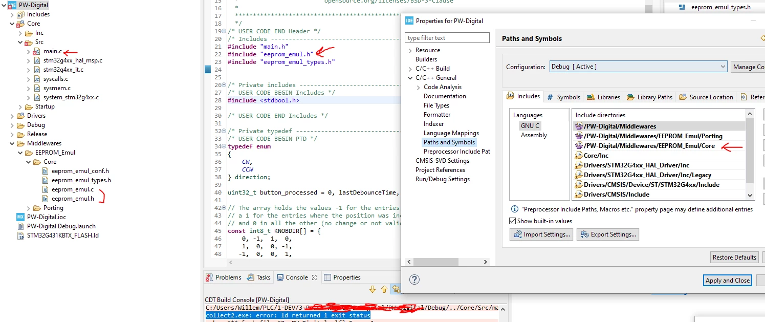

WSpar.1
WSpar.1Author
Aug 23, 2021 8:13 PM UTC
This is the current situation.
Included paths top of the list
Included the header file where EE_Init() is in in the main file
Maybe HAL_init doesn't know yet some parts that er needed?
The EEPROM emulator examples ST provided are not made with an .ioc file for CubeIDE Device configuration tool

Grant Bt
Aug 25, 2021 2:34 PM UTC
That eeprom_emul.c doesn't appear to be part of the build. The folder and/or C file need to have an icon with a little blue thing or else it's ignored. Right->click -> Resource Configurations -> make sure it's not excluded from the build (which it is).
WSpar.1
WSpar.1Author
Aug 25, 2021 8:21 PM UTC
So the C and H in the icon should be a blue solid letter?
I pasted the whole Middlewares folder into my project
When I build the project, the IDE showed the Middlewares folder in the project tree.
When I right click on eeprom_emul.c > Resource Configurations there is no marking in front of Exclude build
Grant Bt
Aug 25, 2021 8:33 PM UTC
Go to the folder right above and right-click on that. By default the stuff shows in the tree but it not part of the build process.
TDKBest answer
Aug 25, 2021 8:28 PM UTC
You need to add all directories with source files in them to the source folders.
Project properties -> C/C++ General -> Paths and Symbols -> Source Location
WSpar.1
WSpar.1Author
Aug 26, 2021 8:17 PM UTC
Thanks, that solved my problem.
Probably better to just select the project parent folder.
