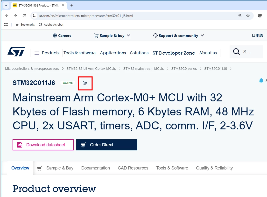

 I would also like to know whether the STM32C011 is covered by ST's longevity program
See the Product Page:
Hover your mouse over the ‘10’ badge:
Click on the ‘10’ badge for full details:
https://www.st.com/content/st_com/en/about/quality-and-reliability/product-longevity.html#10-year-longevity

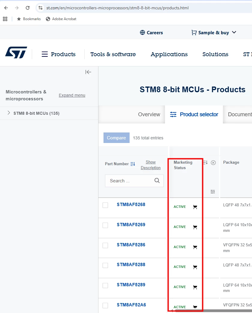

Not all STM8s are NRND:
The top one in that list has the 10-year badge (I didn’t check any others)

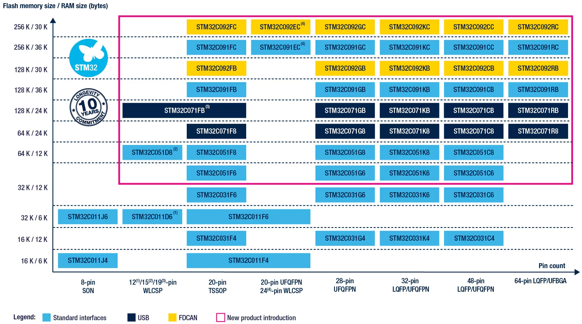

STM32C0 Family overview - showing which are covered by the 10-year longevity:
https://www.st.com/en/microcontrollers-microprocessors/stm32c0-series.html
