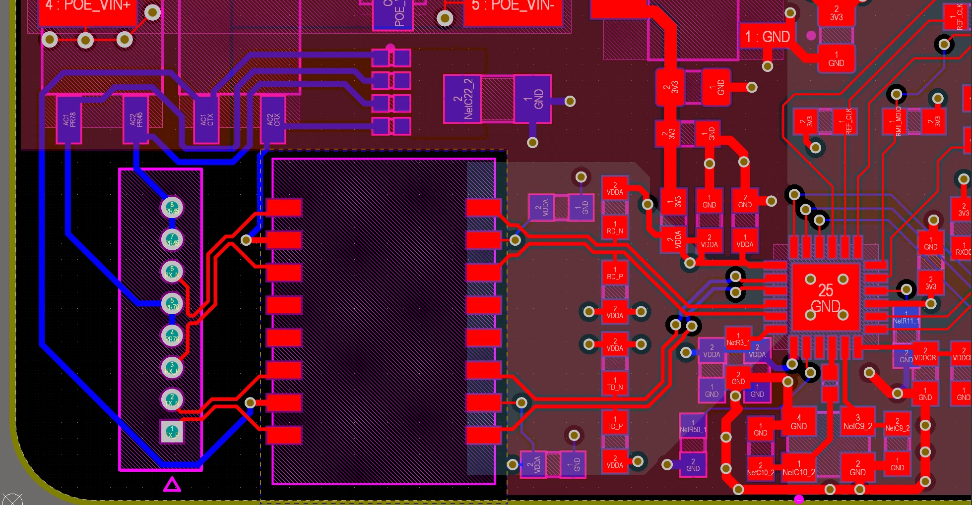

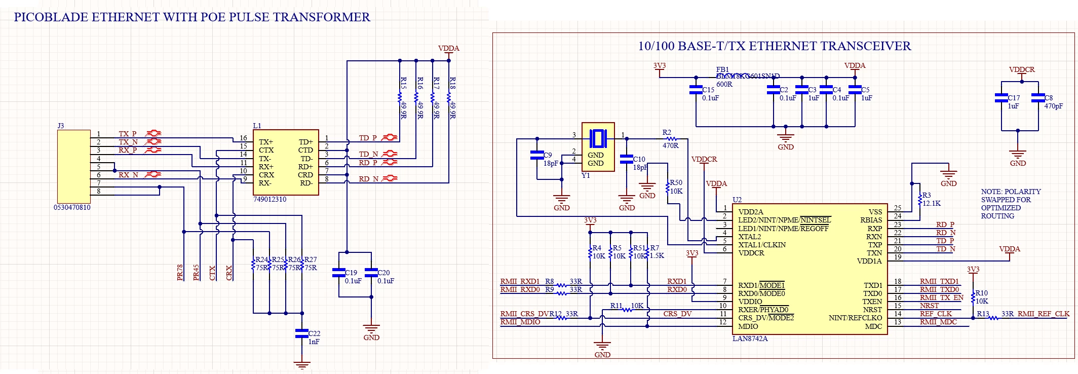

I have a PCBA design that uses a Molex Picoblade connector instead of RJ45 due to enclosure height restrictions. The PHY IC is a LAN8742A and the MCU is STM32H743VIT6, the ethernet is also POE.
I have spliced, a ethernet and 8pin Picoblade connector together to make a 6in cable that plugs into a router. I figured with such a short distance and being 10/100 that while not ideal should still work. I maintained the RJ45 pinout. There is also a POE circuit using a small Silvertel AG9905 module, that is working as expected.

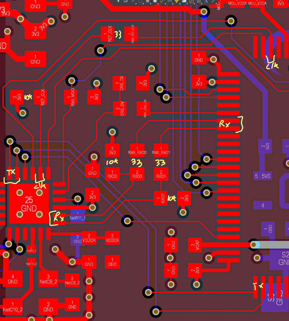

For the remaining 7 I am able to assign them a static IP and random MAC, and I can confirm this by seeing the device connected on the router UI, but when I ping I get host unreachable. Same code same setup with the 3 others with a warm boot I get the ping back and I can open the simple server test program.
The boards all pass the PHY internal loopback test, but not always first go off cold boot.
I soldered in a magjack RJ45 to bypass the magnetics, POE and picoblade connector. The RJ45 works with the 3 working boards but do not fix the issues with the 7 others. That makes me confident that my issue is not with that side of the circuit and is more so related to the PHY<-->STM32H7 RMII side of the circuit.
I have tried tuning the series resistors up and down from 33ohm. My REF_CLK seems stable. I have bypassed the 3.3V LDO with a lab supply to make sure its not a problem with the power supply. I have added more bulk capacitors to the LAN8742A and the MCU, 10uF everywhere I could find. I have tuned the load capacitors on both the LAN8742A and STM32H7 crystals and even swapped in higher tolerance crystals.

Additional info. The original design has the NRST from the MCU and LAN8742A tied together like the Nucleo dev board and push button.
I took a non working board and cut the trace and wired it to PB0 to add a startup delay but that did not work.

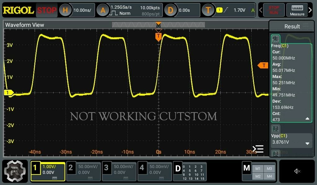

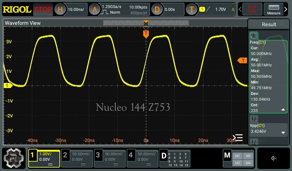

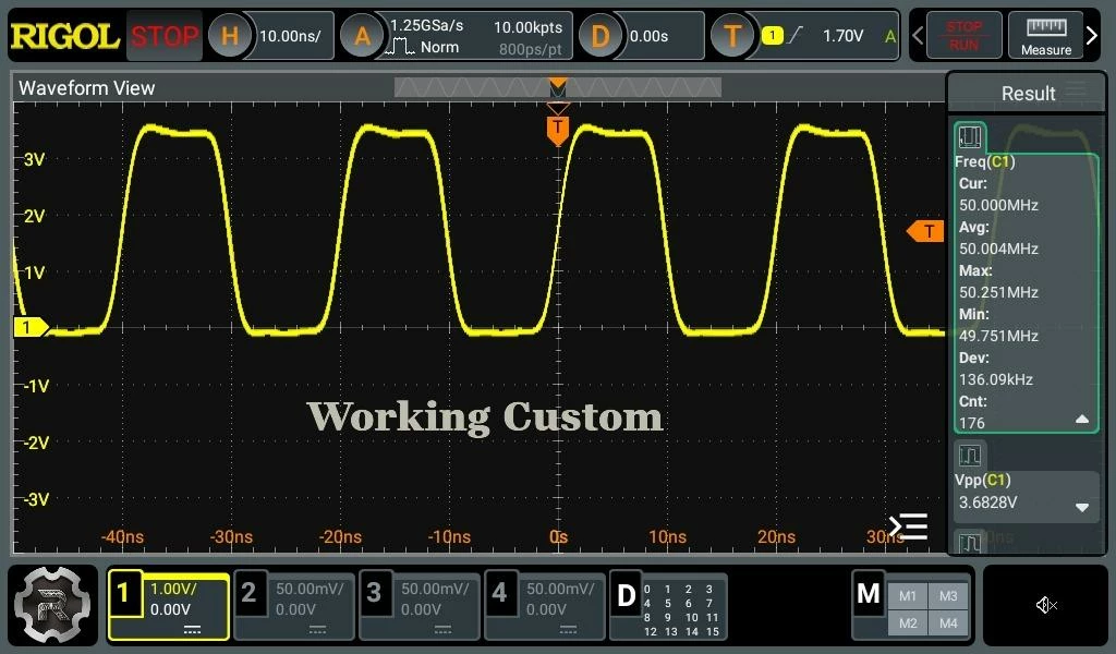

I have probed the REF_CLK of 3 boards, a working, non working and nucleo 144 Z753 for comparison. Looks like I am within tolerance no? I have attached those scope captures of each of the 3 boards REF_CLK, with a 150mhz probe and spring clip.
It seems like the TX lines are working on the non functioning boards but there is a problem with the RX? The router is able to see the device connected at its assigned IP, the MAC is read correctly, but pings from the PC dont receive back.

Just from your scope pics - what you set the pin speed to ?
Try setting all pins used here to medium or med./high - and then check working....
(to reduce reflections, because these cpu's are really fast switching on the pins )
