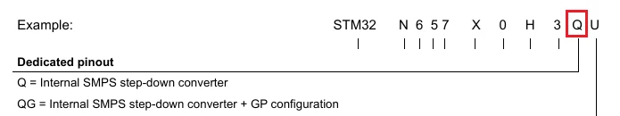

can someone explain what the GP configuration of the STM32N6 is?
I can only find information that the dedicated pinout is different (Datasheet Chap.7) but no more information whether this has any influence on the functionality.

Hello @Mreppold ,
GP stands for General Purpose.
Here are the explanations regarding the naming of the VFBGA169 and VFBGA169GP packages.
These two packages contain exactly the same die. There is no difference in peripherals, the NPU , the internal memories, or the SMPS (please refer to DS14791 Rev 10 Table 3). Knowing that all STM32N6 series embed an internal SMPS.
Compared to the VFBGA169 (STM32N64xA0H3Q) package, the only differences of VFBGA169GP (STM32N64xA0H3QG) are the following:
  • It exposes a 16-bit XSPIM-P1 interface.
  • It has a dedicated VDDIO2 power rail.
  • Its GPIO pinout has been reorganized.
What was decided regarding the ordering code (CPN) was to distinguish this package using the last character (Q in the figure below), since it was the only position that allowed the addition of an extra character (Q+G).
Hope that answers your question about the STM32N6 GP configuration.

There are two different versions of the STM32N657A0H3 mentioned through the datasheet:
For example Table 5 lists STM32N657A0H3Q and STM32N657A0H3QG. When I tried to find out what the G stands for, the only information I found was in Chapter 7 where the datasheet states “QG = Internal SMPS step-down converter + GP configuration”.
Unfortunately I could not find and information telling what GP configuration is. That’s why I am asking.
