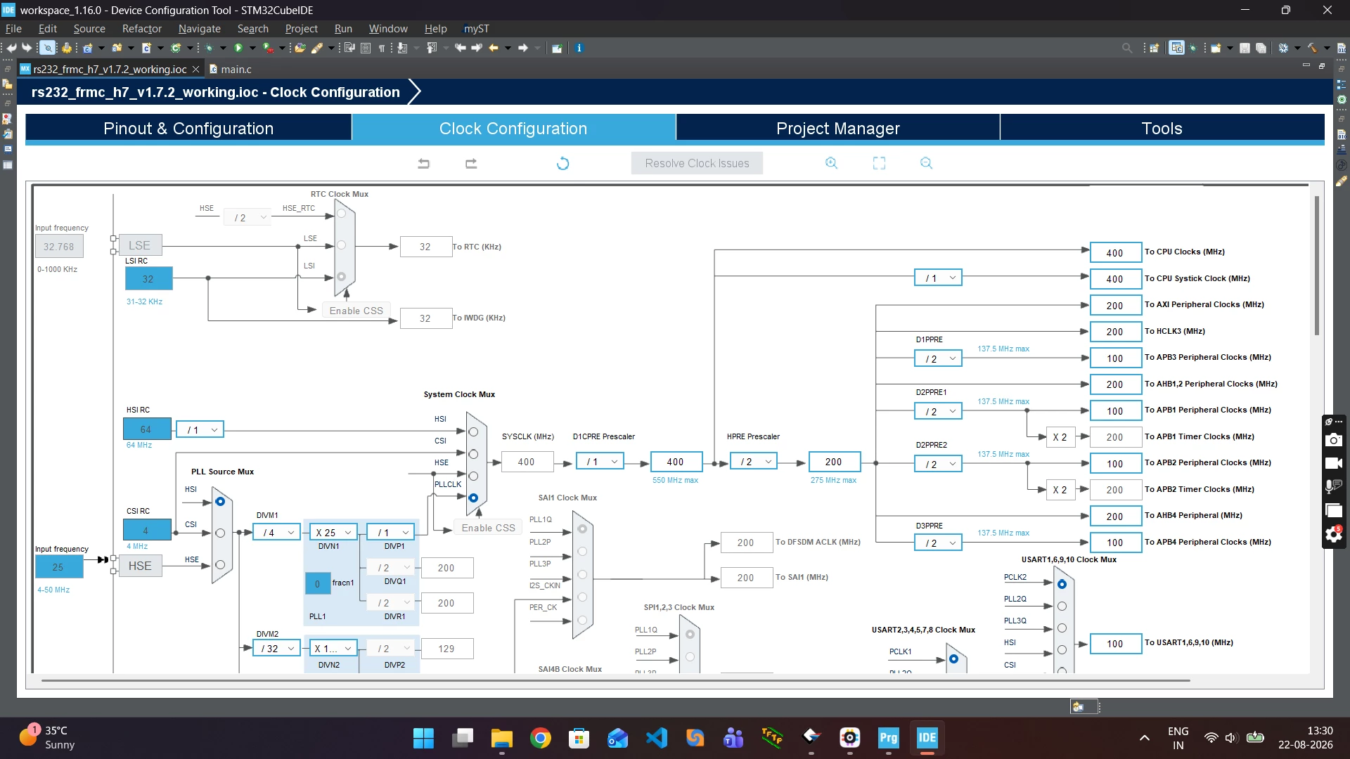

Hi Team,
Please find the attached clock configuration (internal) for my case.
Case : Full-duplex in ethernet.
We are seeing data loss even with the actual crystal part with full-duplex mode. Please review on the clock configurations and review the same.
​There was about to 20 hardware , same PCBA & same purchased lot components, there was some 10 units working without data loss on ethernet full-duplex & other units has dataloss with full-duplex mode.
Please confirm internal clock configurations are suitable for this or case condition ?

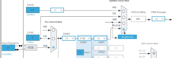

AScha.3
Sep 5, 2026 5:55 PM UTC
no, your clock tree setting is wrong.  Or bad,if you prefer.
You have HSI as master clock source, thats a simple mistake.
You have to choose HSE , and verify crystal frequency (in pic you set it to 25M , oscillator . Is it 25M oscillator?).
Then set PLL divider + multiplier, to get the desired frequencies again.
THEN your cpu + ethernet will work fine and reliable. (even with new crystal on LAN chip.)
about like this:
